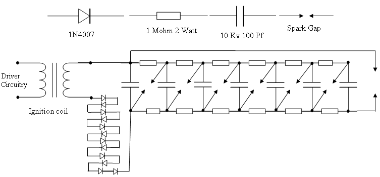

just to give an example, i put this together with word. i'ts not very complex but...... i just get the symbols and move them into place:D Marx Generator.PNG
Word is crap for drawings, use Visio or Correl Draw or OpenOffice.org draw.
