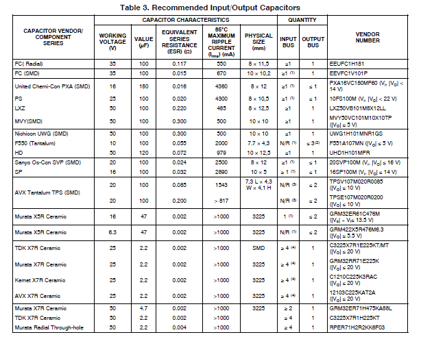

The manufacturer's bulletin has a discussion of which type of capacitor to use and where. It even has a list of recommended capacitors.
They say:

The data sheet list recommended cap part numbers and manufacturers. See attached image.
