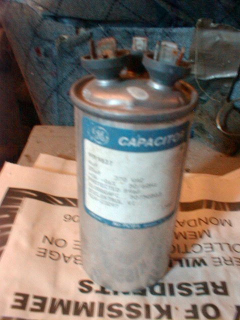

Here's a picture of a bad start capacitor I took out of my AC outside unit. Notice how the top is swollen, and the terminals pushed up? This is what I've seen with bad start capacitors. Don't know how you would check one with a meter, if even posible.
