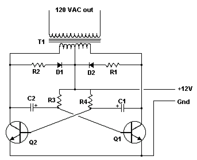

okay i have schem's for a power switching thingy, im hot and tired so i forgot the term, gimme a break, but it turns 24vDC to 120vAC @ 60H. now i wanna hook a amp that runs on 120vAC@60H to this power thing, it has a 120vAC-25.2vAC CT@2A powering it.
is there a way i can replace both tran's with 1 tran and run it off my car batt?
(the schem for the 24v switcher has a step up system to make 12vDC into 24vDC)

24vDC-120vAC
input 12vDC
output 120vAC @60 hertz
thats all i know about this one, still doing research.

now i added the schem for the amp too, its not real detailed, i drew it up in paint myself.

That inverter circuit is completely useless - just buy a car amp, they are available at VERY little cost, far cheapoer than you could build anything comparable.
The 25.2V center-tapped transformer produces a power supply that is plus and minus 16.8VDC.
With this power supply, the LM1875 IC produces only 12W into a 4 ohm or 8 ohm speaker.
Each amplifier produces 10W max of heat.
Most ordinary car radio amplifier ICs produce 15W into a 4 ohm speaker and do not use a transformer.
If you buy a car radio amplifier that says 200W then its output is actually 15W per channel but it has 4 channels.
Manufacturers lie about power ratings. 200W is 200 Whats which is a total of only 60 Watts.
