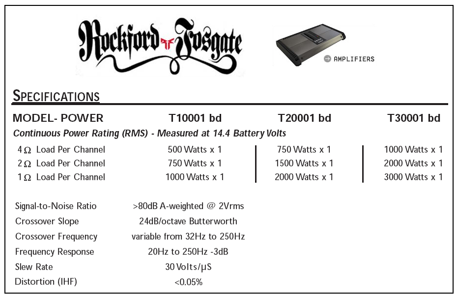

It's VERY, VERY unusual to see RMS specs on in-car amps, and if given it's usually in small writing below the grossly inflated figures in the main spec. What make and model is it?, and what do they claim?.
Hi Nigel,
My son bought the smallest amp:

Hi Nigel,

My son's sub-woofer amp is rated at 1kW RMS continuously into a 1 ohm load with very low distortion. But his speaker is 4 ohms and draws only (?) 500W from it continuously. With people in the car, the amp probably idles along at 100W maximum and 10W average. When he plays basketball (away from the car), he probably cranks it up but its average output is still only about 50W or less because the sub-woofer is used for only the beat of the music which has a low duty-cycle.
