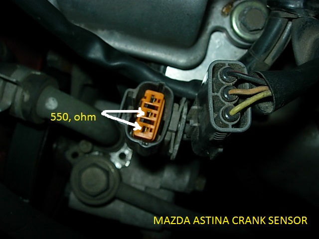

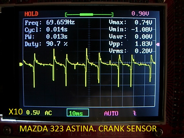

My mazda has a crank shaft sensor that is inductive with 3 wires but only 2 are used. This is the output of it. Has a resistance of 550 ohms

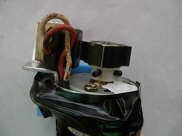

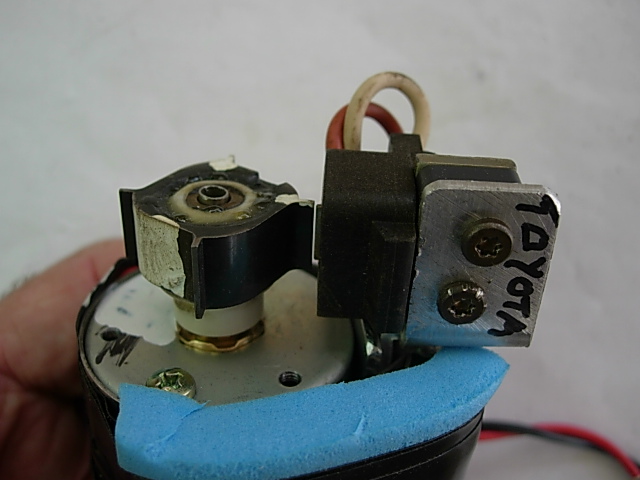

This is my tester made out of an old VCR Capstan motor with Toyota parts. I can vary the speed of the motor.

Still confused. First signal does not look like an analog signal at all. It turns on, dissipates, turns off and then right back on again. You can see the second one is analog as it follows the exact curvature of the vanes and is opposite to the first one. It ramps up voltage and then suddenly shuts off. That makes sense to me. I will have to look into this because I have not seen a three wire inductive sensor used in automotive. Or if I have, never paid enough attention to them. Always looking for an education. New topic to research :) Thanks Debe.
The Mazda sensor is definitely an Inductive sensor. There is 3 wires only 2 show a resistance, The 3rd black wire may go to a shielded braid as theres no conection to the sensor.

That would still make it a two wire sensor but what do I know. On the other hand, if this is a Hall effect sensor as you say, where does the resistance come from? I know an inductive sensor is a wire wrapped around a permanent magnet and will have resistance on it, but not sure where resistance comes from in a Hall effect. As well, a Hall effect sensor has to have power, ground and signal so how do these two wires pull that off? I have a Picoscope and generally, all 3 wire sensors that are digital, emit a nice square wave pattern. I don' t see that in your pattern?
