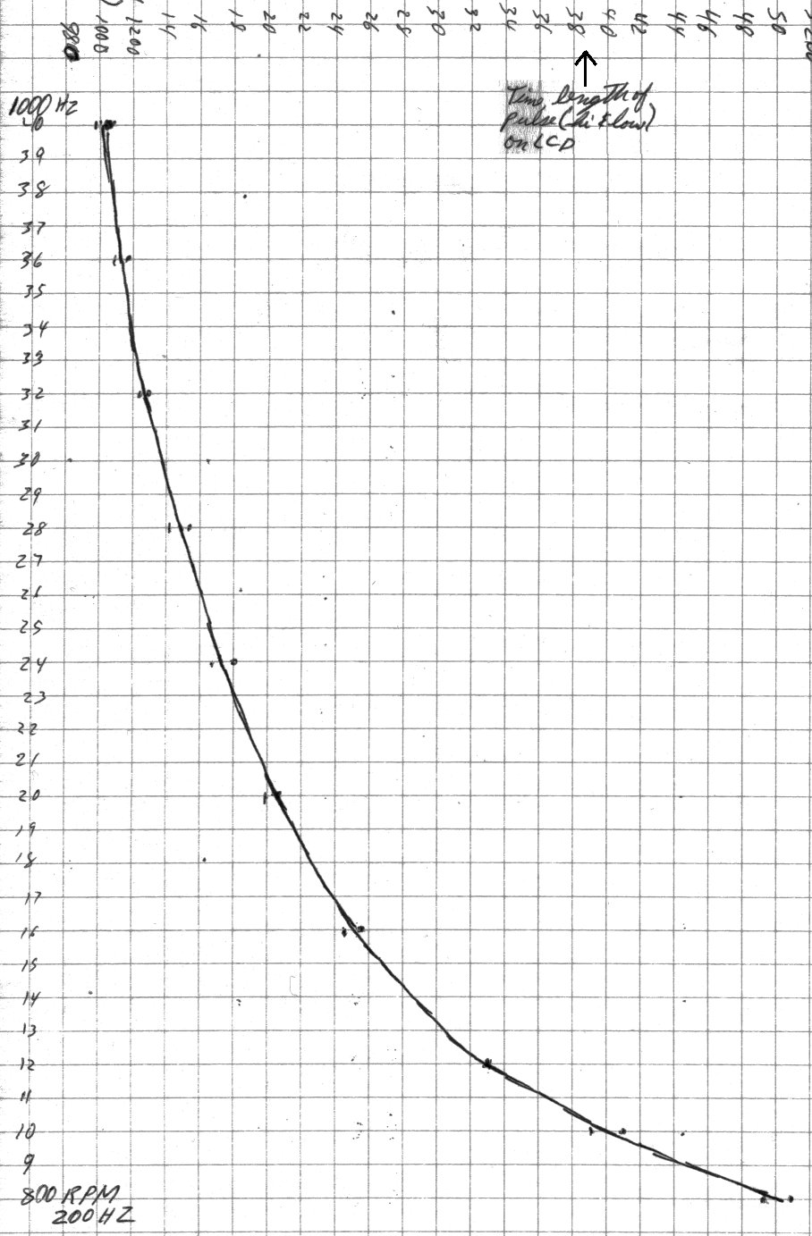

I have been working on a tachometer lately. For low frequencies, someone recommended reading time between pulses. I tried that and found that as the frequency increases, the time between pulses shortens EXPONENTIALLY. I didn’t EVEN want to sort that out in PIC asm with RISC.
Anyway, you gave me an idea. A hall effect sensor close to the differential ring gear should give you 20 or more pulses per axle revolution. Has anyone done that?
I suggest you try again, the relationship between frequency and wavelength is a simple linear one.
That is what I expected but not what I got. I will scan a graph of it.
Nigel, this is from your joystick tutorial but using timer1 and no cap discharge.
ReadX ;clrf Timer_H ;clear timer hi byte
bsf STATUS, RP0 ;select bank 1
bsf JOY_TRIS, PotX ;make PotX an input
bcf STATUS, RP0 ;select bank 0
clrf TMR1H
clrf TMR1L
btfss JOY_PORT, PotX ;These two to make sure it starts at a full cycle
goto $-1 ;loop until input high
btfsc JOY_PORT, PotX
goto $-1 ;loop until input low
bsf T1CON ,TMR1ON ;start timer
bcf T1CON ,TMR1ON ;stop timer
movf TMR1L, W
movwf LoX ;and read immediately
movf TMR1H, W
movwf HiX
retlw 0x00
