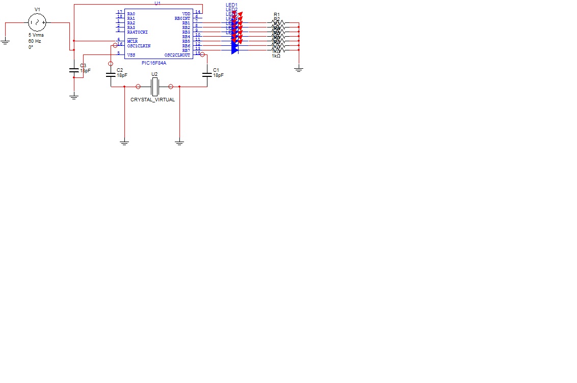

this is my schematics using multisim.but i didn't find the compatible sensors or component for sense the vacancy parking lot yet. can anyone help me?

The xtal is incorrectly wired.
The wire ends of the crystal go to the PIC pins and a low value cap is from each xtal pin to 0v.
thanks. i will try to fix it. can i use sensor encoder for this car parking system? or do you have any suggestion about the sensors for this system?
