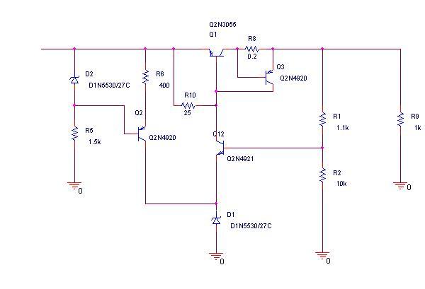

voltage regulator
this is a voltage regulator but i think you should work on it. :D
There are two ways to do this:
1. Make a transformer or boost converter to guarantee you have at least 12V. The boost converter can't drop voltage, the lowest it goes is to act as a straight wire, so you could do a voltage regulator to drop it. This can generate buttloads of heat, if you have 18V@5 amps to 12V, that's 30 watts of heat!

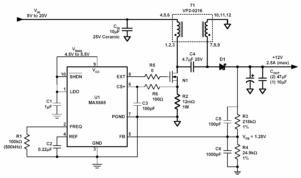

I found a diagram with small help
Now ? is I want to change to 5A
