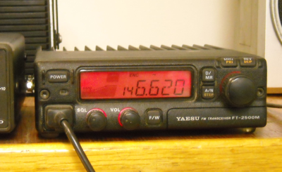

I have several mobile ham rigs that use the small "grain-o-wheat" 12V lamps as illuminators. Those damn things are always burning out. The reason is that with the car's alternator charging, the system voltage goes as high as 14.5 V or even higher, and those little lamps have a very short life even at 12.0V
Since I have to open up the radios to solder in new lamps, I fix the under-lying issue (12V lamps running on 14.5+V) by wiring a resistor in-series with the lamps to drop the voltage about 15%. I have actually modified a couple of the radios by replacing the lamps with LEDs (several in series) in series with a current-limiting resistor.
Off the top of my head I cant remember what resistor value I used, but it extends the life of the bulbs to where I am not having to get into the radios very often...
Here is one I converted to LEDs. I cut the dome off the water clear red LEDs to get a more diffused light.

Actually, since I'm running 4 or so Red LEDs in series (Vf=~2V), they dim quite nicely...
