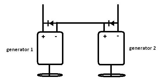

Hi guys,
I'm wondering: is it possible two combine two identical DC generators to produce twice or less output power? I imagined that it would be impractical to combine the terminals directly, so there might be a converter circuit which simulates the output of a battery, and these output terminals can be combined in series with other converters and produce an effect similar to combining batteries in series?

I don't see why you couldnt connect them in series for more voltage. Or parallel for more current. You'd want low value resistors on the lines though so the generators wouldn't back feed into each other due to non-identical voltages on a parallel connection.
You need diodes to prevent back feeding, resistors will just waste energy.
Connecting them in series is probably the most efficient way but if one of them is not turning it will be fed from the other one causing it to behave like a motor.
series with rectification from each generator or directly connecting them in series?
That won't prevent back feeding.
To prevent back feeding when the generators are in series, you need to connect the diodes in reverse parallel with each generator.
Assuming the generators are AC, connect them up like this.
Obviously, diodes will not work with AC voltage.
Thanks uncle.
Er, is there a typo? A bit confused here, but what do you mean by 'not working with AC voltage'? I thought it'll just cut off 0.7V from the AC output, ain't it?
No, worse, it'll short circuit every half cycle, if it's AC.

Yes it was a typo, I meant: assuming the generators are DC, connect them up like this.

I don't know what's wrong with me, I made the same typo on my post that was supposed to correct it.
I've edited my previous post.
Do not connect diodes in parallel with AC generators, they will blow up.
