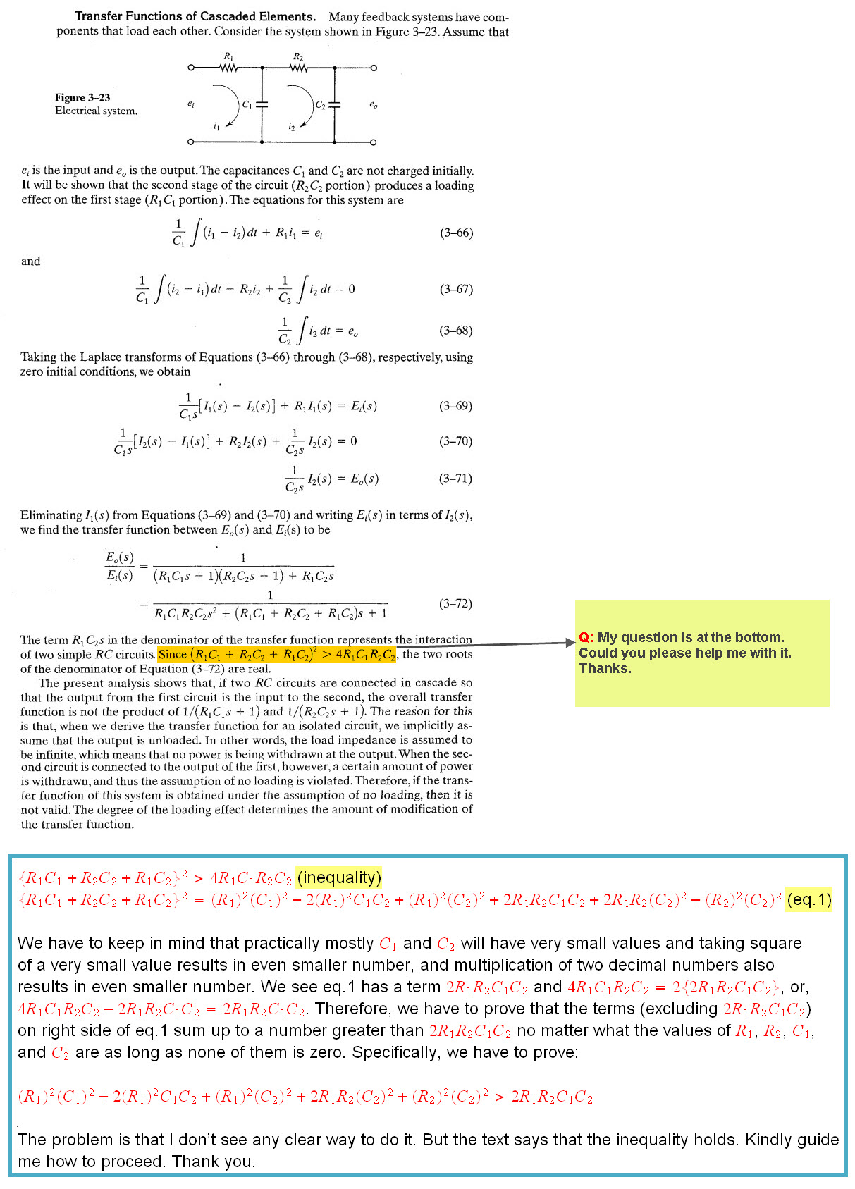

Hi
Could you please help me with this query? Thank you.

Let us set:
R1C1=T1
R2C2=T2
It is easy to show that
(T1+T2)^2/4*T1*T2 always is equal or larger than unity (equal to unity only for T1=T2).
Now,
because the sum in brackets is even larger due to R1C2, the inequality is always fulfilled.

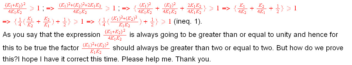

Thank you, WS.
I hope I'm following you correctly.
Isn't it possible to prove it the way I was trying to do here at the bottom? Kindly let me know. Thanks.
Regards
PG

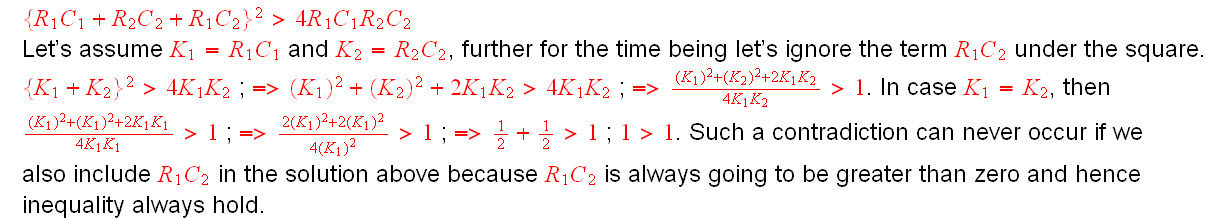

Thank you, WS, MrAl.
In your calculation, it is NOT correct that
(K1+K2)^2 > 4*K1*K2. For K1=K2 both sides are equal.
I hope this time I'm interpreting what you said correctly but I'm still stuck. Could you please help me? Thanks.

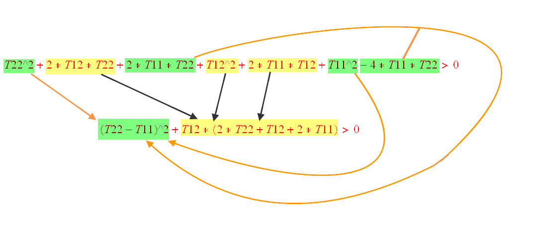

Hello again,
I think i see where you are trying to go with this.
The idea is to try to force this to be an inequality that is compared to zero, as: equation>0 or equation<0 and to make equation always positive or always negative.
Setting the following variables:
T11=R1*C1
T22=R2*C2
T12=R1*C2
noting that the first number of the 'T' part is the resistor number and the second number of the 'T' part is the capacitor number.
And also note that all three of these are always positive because all the R's and C's must always be positive in a real circuit with regular physical components.
The original equation is:
T22^2+2*T12*T22+2*T11*T22+T12^2+2*T11*T12+T11^2>4*T11*T22
and subtracting the right side we get:
T22^2+2*T12*T22+2*T11*T22+T12^2+2*T11*T12+T11^2-4*T11*T22>0
so we've accomplished one goal, we got an equation that is all on one side compared to zero. But the difficulty that comes up is that we have a subtraction in the left hand side, and that means it's hard to tell when this equation holds. It turns out though that all we have to do is factor the left hand side and we end up with an equation that must always be positive that is compared to zero.
The original equation after the subtraction then factors into:
(T22-T11)^2+T12*(2*T22+T12+2*T11)>0
and from this we can see that we moved the negative part of the equation under the square so that combined part must always be positive. So we now have it in a form:
equation>0
where equation is always positive, so we've proved it except for the case where all three new variables are equal to zero, but that's a topological impossibility so we're ok.
