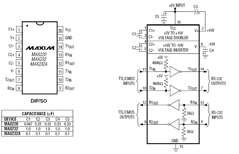

You don't mention if you're using MAX232's or not?, if you were, you could use those to chain the different units together.
So, RS232 into a MAX232, 5V output to PIC (as usual), but connect the 5V output to the 5V INPUT of one of the MAX232 outputs, giving another RS232 output to feed along to the next device (complete with it's own MAX232).
This has the added advantage of increasing the range of the RS232, as it's buffered and amplified through every MAX232.

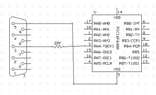

Thank you to both of you. That sounds like a good option. For now, while I am waiting for my shipment of supplies I am working on a test board without a MAX232. I have a schematic that connects the RS232 to the pic with a single 22k resistor. Has anyone done anything like this before? The schematic shows:
PIN 3 --> 22k --> Input pin on PIC
PIN 5 --> GND
Could I use that for some testing?
I have never used that resistor between PIC and MAX232, I think it's safe to leave-it-out. MAX232 has 4 buffers, you will only need 2 (for TX and RX). This should explain it:
Without the MAX232. Like this.
Yes, the pic would only be receiving data from the PC.
Yes, that's fine, but it means you can't use the hardware USART, you have to use a software one. Also, it means you can't run as long a wires, the MAX232 buffer suggestion I made earlier (and Jay did), uses it as a buffer on each board, allowing you to have much longer connections.
