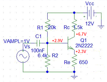

Why is your schematic as big as my neighbourhood?
I cropped it and used Ohm's Law and simple artithmatic to calculate the voltages.

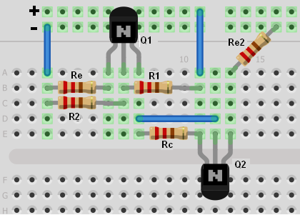

I want to understand how to 'put' the CE + CC configuration in cascade on a breadbord :/ im using a virtual one like that:
https://imgur.com/IS3Z9
I think i must use also the oscilloscope for misurating Vin, Vout and Av = Av1 *Av2
Yes I understand this, but what is the physical type of the BJT you are using in the breadboard (2N2222) ??

Another 2 questions:
1. in that figure i dont see the capacitor Cin, its normal or i must put it too on breadbord?

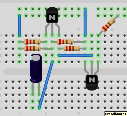

Yes you need to place Cin capacitor in the breadbord
See the attach file.

  • ce+ccx.zip
