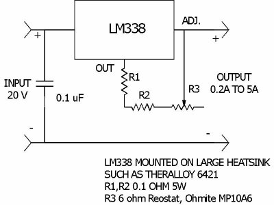

I am a hobby machinist and I am starting to add ALuminum Annodizing to my home hobby shop. The method I will be using requires a controlled current power supply for best results, but they are fairly expensive. ($3-400)
My requirements (ideally) are a 0-15V, 0-3A CC unit. Most units like this also seem to have Variable/controlled Voltage, but that is not a necesity for this dedicated power supply. I need to maintain a controled current density and let the power supply vary the voltage as the annodic material varies its resistance [as coating is deposited].
Whe the resitance peaks and the voltage starts downward....voila! She is done! For this part, a meter would be nice. I guess an built-in curent meter would be nice, too. ALthough both could be digital to keep costs down.
I can construct almost anything so if anyone has a schematic for such a power supply I woud greatly appreciate a look at it.

I suggest using an LM338, as it is a 5 amp regulator. It can be configured as a constant current source that is adjustable in current. I don't think it
will go down to 0 current however. If you can give me a figure for minimum current I see I can provide you a schematic with parts list. I suggest that you consider a fixed supply about 20 volts and let the current regulator provide the adjustable current, thus the load voltage will be the 20 volts minus what is dropped across the regulator.

K7, the reason for the [adjustable] constant current is due to the nature of the process of annodizing. Low, cntrolled current is safer and more predictable than uncontrolled current, as there is electrolyte involved which creates a mist. Also, the voltage will self-adjust upwards to maintain that constant current as the resistance by the work-piece raises due to the barrier layer being deposited. When it reaches its peak, the process will start to reverse itself & the voltage will start dropping. THis signals the end of the process and the operation is halted.
The minimum current I could operate with is probably about .25 amp.
So, an adjustable current of 1/4 amp to 5 amps would be perfect.
The voltage required would be between 1V & 15V. I believe these parameters would cover any home-level projects that I could handle in the tank I am setting up.
If more voltage were needed than the max of the supply at a given current, all that would happen is more time in the tank would be required to reach the peak.
These paramers have been estabished to get a good balance between Hardness, Time, and Porosity of the deposited annodic layer.
Typical time is somewhere between 20 minutes & 1.5 hours depending on the grade of Aluminum being annodized.

CC regulator
The attached circuit is for an adjustable constant current source. The drop across the regulator can be about 3 volts and the voltage drop across the adjustable resistor will be 1.25 volts thus the 20 volt input.
The size of the reostat may seem large 25W, but that is the dissipation for the whole reostat. When it is near 0 ohms it will still be dissipating some
heat. A good sized heat sink is necessary for the LM338 as it has internal current and power dissipation shut down if the current and power are exceeded. Hope this helps.

Wow, that's pretty straight forward! Thanks!
So, just to make sure I understand this all correctly:
The above circuit, when supplied with a 20VDC input, will provide me with an adjustable (via R3) constant current that will automatically adjust the voltage up & down as the resistance at the output changes.
Correct?
What do you recommend I feed this with at the input to get what I need? Regulated 20VDC? At 5 Amps?
CC reegulator
Yes you are correct. You can put an ammeter in series with the output to monitor the current. There are a number of digital multimeters that are in the $20.00 range that measure up to 20 amps. The input does not need to be regulated, but if it is it will probably work better.
