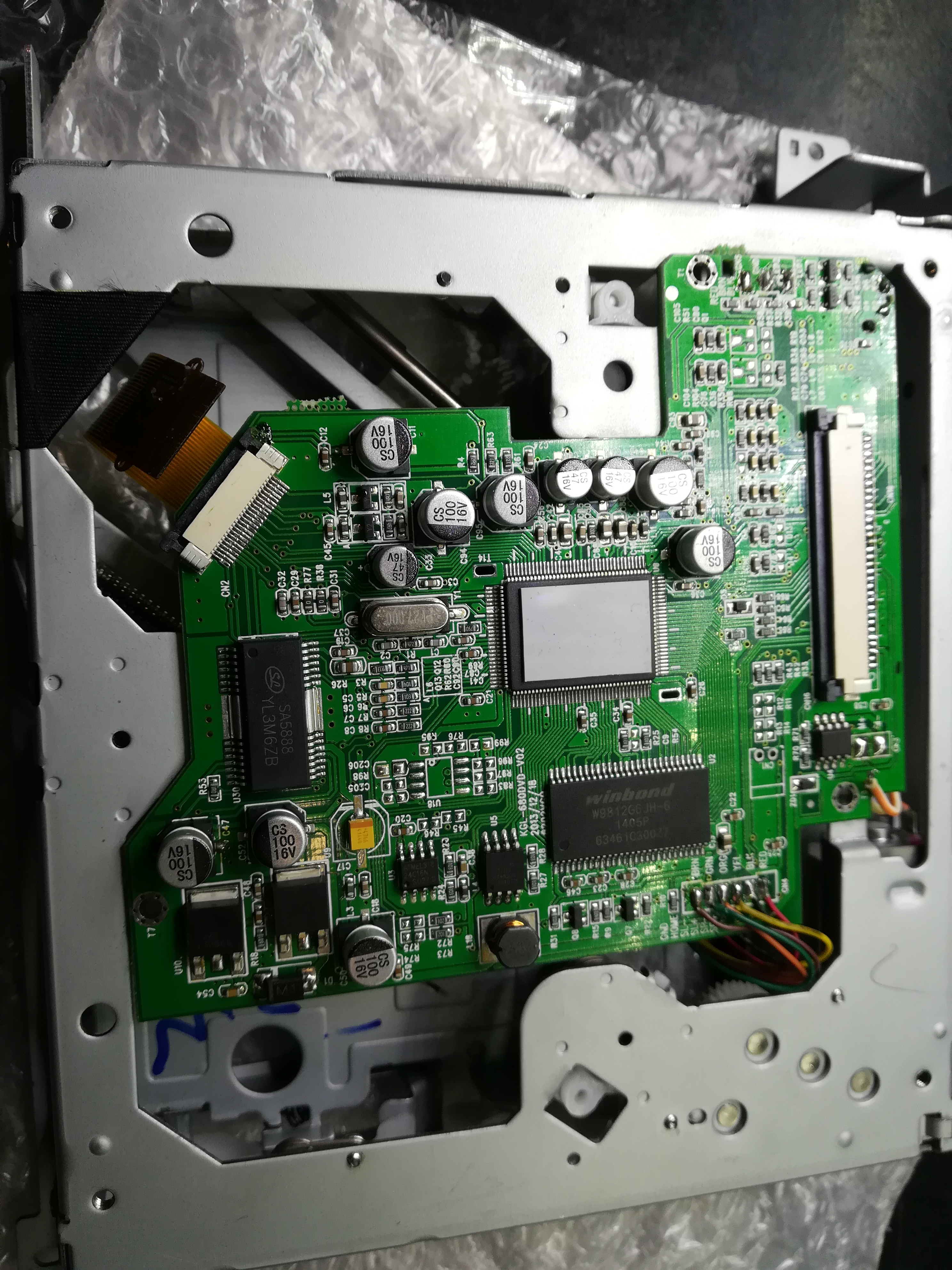

I have a car radio and the cd driver is not working. I disassembled and I verified that the mechanism does not engage the gearwheel to down the CD. Can someone help please?

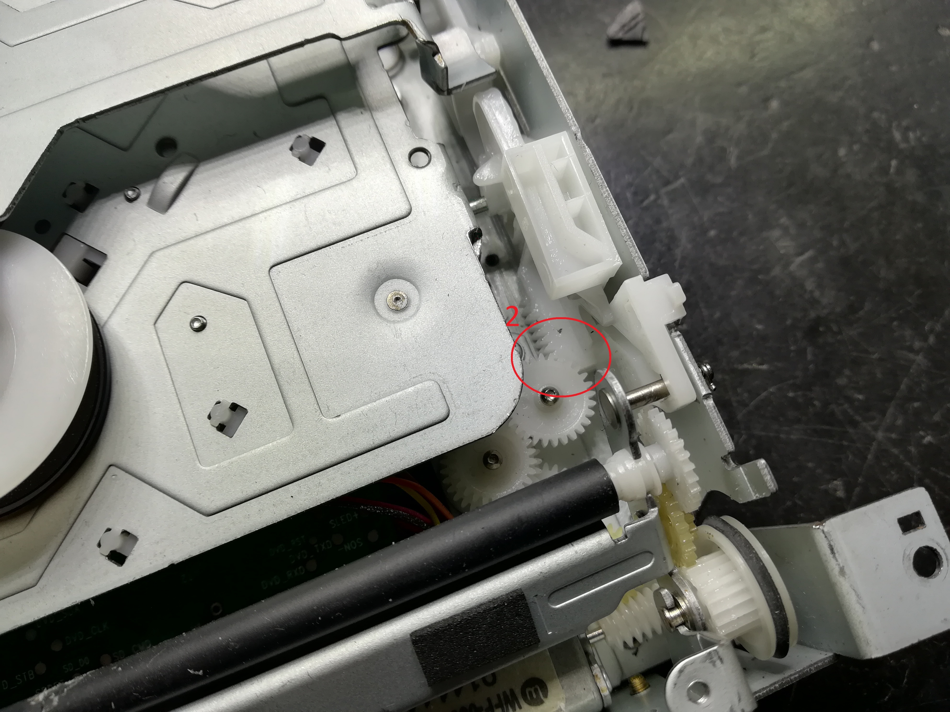

It looks like the nut came off of the screw at the bottom of your circle. From one photo, it appears to me that the gear has then lifted up and no longer meshes with the rest of the gears in the system.
Thanks by your answer. Is possible, I did find a lost screw on CD driver. I am a nebbie in this system, can you explain where do you think that is the screw? Thank you a lot
It appears to be a slot-load drive.
The mechanism to clamp a disc should not engage until some sensor at the back of the mechanism detects a disc has been pulled in and is in the correct location for the centre spindle to engage.
Can you actually see that highlighted gear turning without engaging the rack? I'd expect it to have a smaller pinion on the underside for that, rather than the upper part engaging direct; that's the bit the oncoming drive from the other gears connects to.
If I'm looking at the same screw thread as Gophert, I'd say that is attaching something to the chassis and the visible end is just excess thread beyond a threaded hole in the metalwork.

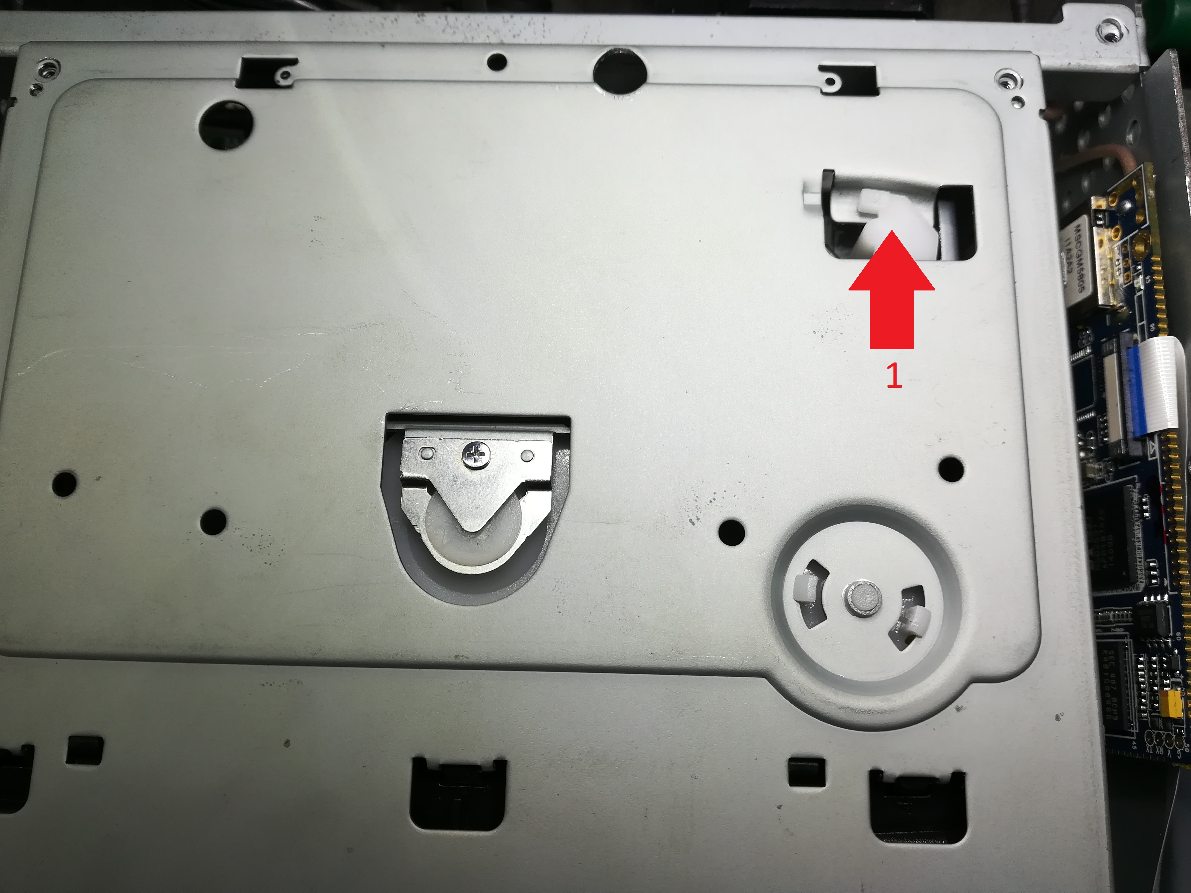

The situation is this:
when I put the CD, it goes to right position. However,the mechanism (marked with number 1 on picture) needs a small hand help to put the mechanism (marked with number 2) on position. Without help, the mechanism stays near but not on position.

At some point, materials fail, mechanisms bind and the device is ready for the trash heap. The fact that the folded table has pulled out of position means any repair will be short-lived. You might want to consider a subscription to a music streaming service. I've been super satisfied with Spotify.

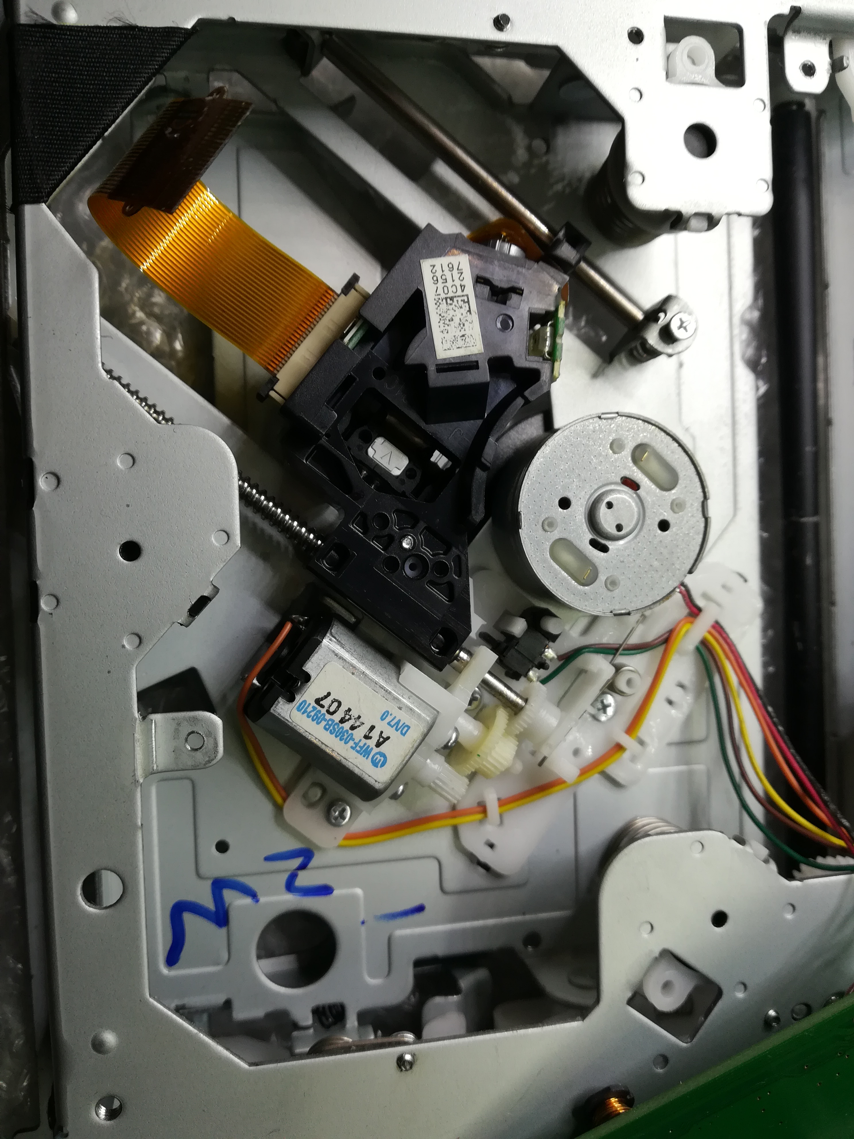

The belt is ok.
If I put a small piece of plastic attach to mechanism (where the CD touch) it´s works wel... but is a bad solution :D
It sounds like something worn or bent?
Can you see what that part operates further in the mechanism and adjust it somewhere?
