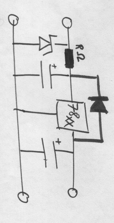

The addition a of a diode such as 1n4001 for example
across the regulator can smooth out small ripples in the supply
and improve the stabilty of the output of the supply to the cd player.
[apologies for posting picture sideways am in a hurry]
:oops:
yeah, 13v should be fine. any zener between the normal voltage level of the socket, and the maximum input voltage of the regulator would work. most voltage regulators have reasonably high maximum input voltages to begin with, so spikes of 20 or so volts shouldn't be a problem anyway, but cars can have some nasty spikes sometimes; I don't have a lot of firsthand experience with it but i've heard that spikes of 100v or more are not unheard of. so the zener, and the capacitors, should be a huge help. you might consider putting some bigger than usual capacitors on there just in case. they're cheap enough.

tansis, sideways is fine...! what sort of value is the resistor?
cheers evandude, that really puts my mind at rest, knowing that i have accounted for any spikes (it was because i'd heard of these spikes that I was asking the questions in the first place)

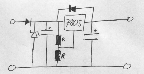

True 7806 regulators are not that common, one solution is to use a more available device like the 7805 and fool it to produce six volts by creating a virtual / artificial value for the zero volt rail with a resistor divider.
I have changed the resistor from the previous drawing to diode you will notice, this is stop the feedback diode and regulator from trying to stabilise the entire vehicles electrical system, often you will hear of automotive electronics refered to as 12vdc... well it varies somewhat!
with the engine running ,eighteen volts is not uncommon.
Bolting the heatsink to the case is a normal way of doing things, provided its a metal case! also it it worth the extra expense of an insulating / mounting kit ,the device heatsink / mounting tab is often connected to the semiconducter substrate and is best isolated for safety reasons, that and should the case short out other wires where it is mounted your electronics will be safe. Thermal grease is a nice finishing touch but claims for this gunk are much overated, and modern kits are comprised of a soft washer designed for dry use, overclockers of course will swear blind that copper or silver loaded paste works better, but the minor benifts are swamped by the extra cost.
Keep in mind that the 7805's internal SC protection won't work if you give it a virtual ground ...

in the diag posted by Tansis, what sort the rating does the zener need to be?. The max current will be about 1A, and the expected voltage will be about 12-20v. Presuably I don't need a zener rated at 20Watts!?!?
No, the zener is in parallel with the supply, not in series, so the current doesn't go trough it...

Tim,
The voltage in the socket will rise to 13.8 or more when the alternator charges the battery so the Zener will conduct and get destroyed. You should use a 16 V or higher Zener or just omit it. To protect the regulator put an extra cap in front of it paralleled with the electrolytic and as close as possible to the regulator, use 0.22uF. You should not exceed 1.5W without a heatsink on this type of regulator so the maximum current without heatsink is something like 150 to 200mA in this case. You don’t need any insulation for the mounting just remember that there will be (ground) negative in the box. If you are using a 7805 a way to rise the output voltage is to put some diodes in series with the ground connection (cathodes pointing to ground) and you will rise the voltage 0.6V or so extra per diode.
Ante :roll:
oh. So tansis was wrong...?
ceramic? non electrolytic?
is that even if I use the case as a heat sink?

Tim,
The electric system in a car can reach as high as 14.2Volts when the alternator is charging. I am not saying that someone was wrong just by thinking (12V). The extra cap can be any poly non-polarized types just remember short leads.
