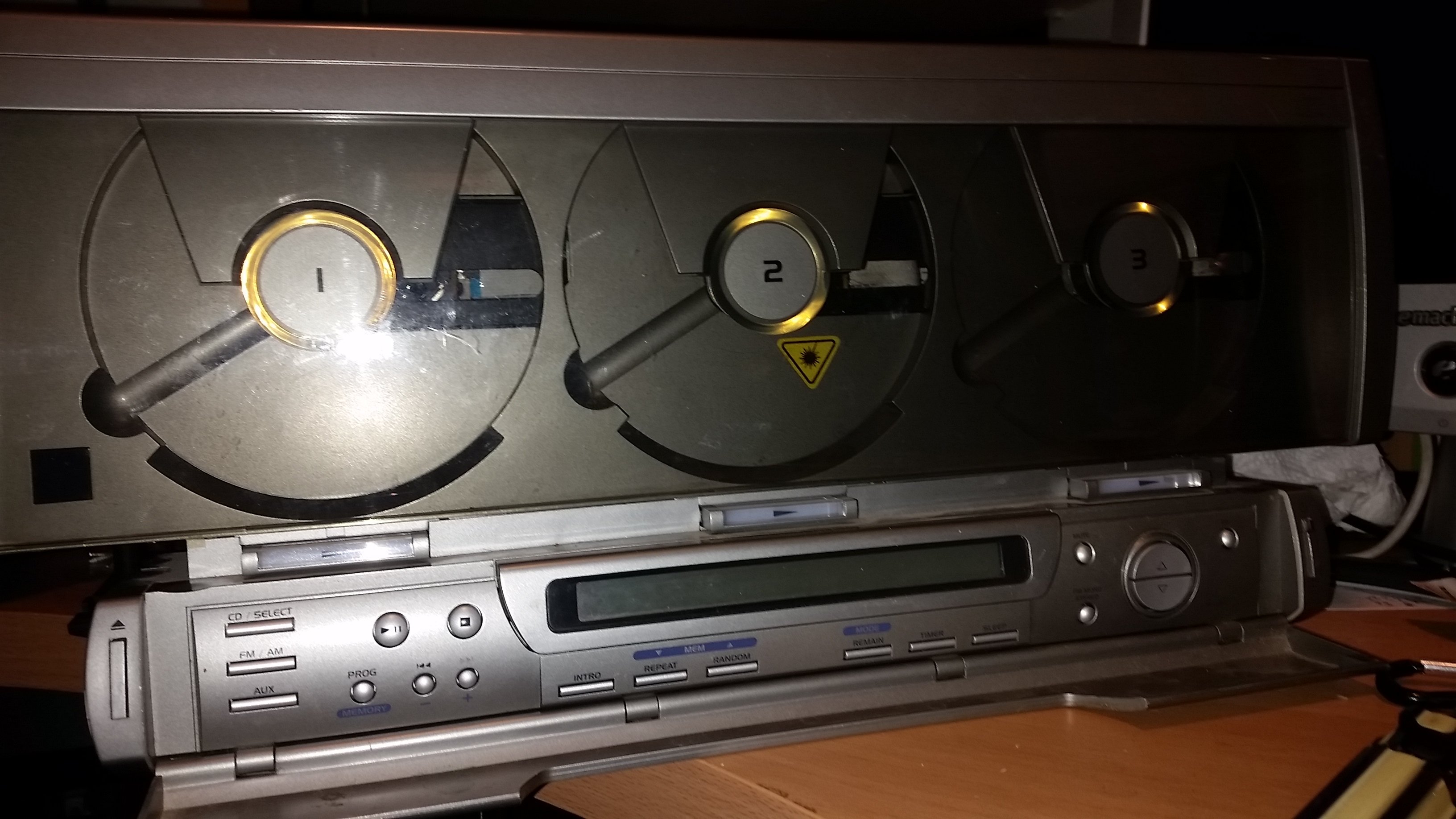

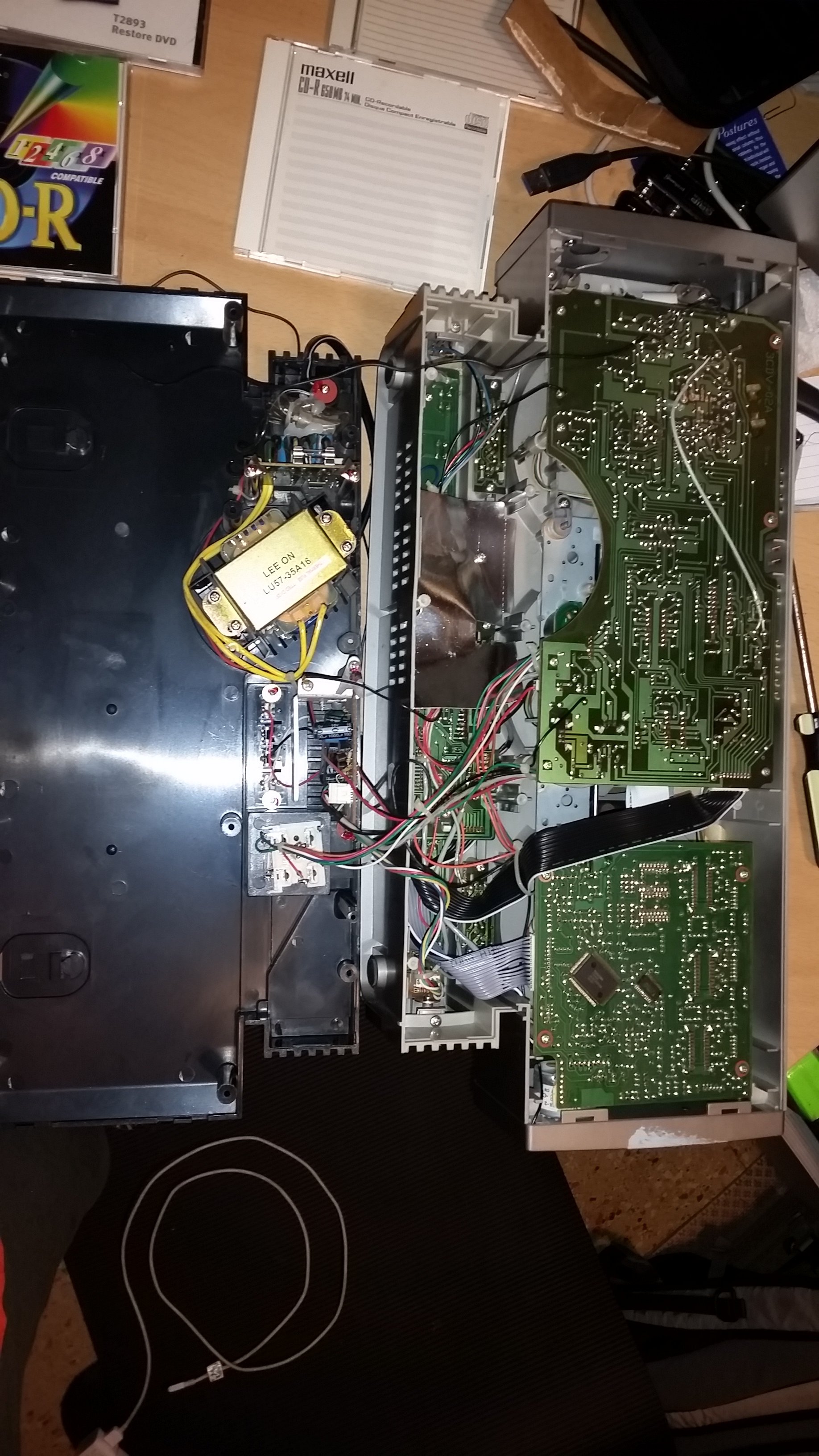

This is an image of what the device looks like inside and out. I don't have any test gear other than a Harbor Freight volt meter (freebie).

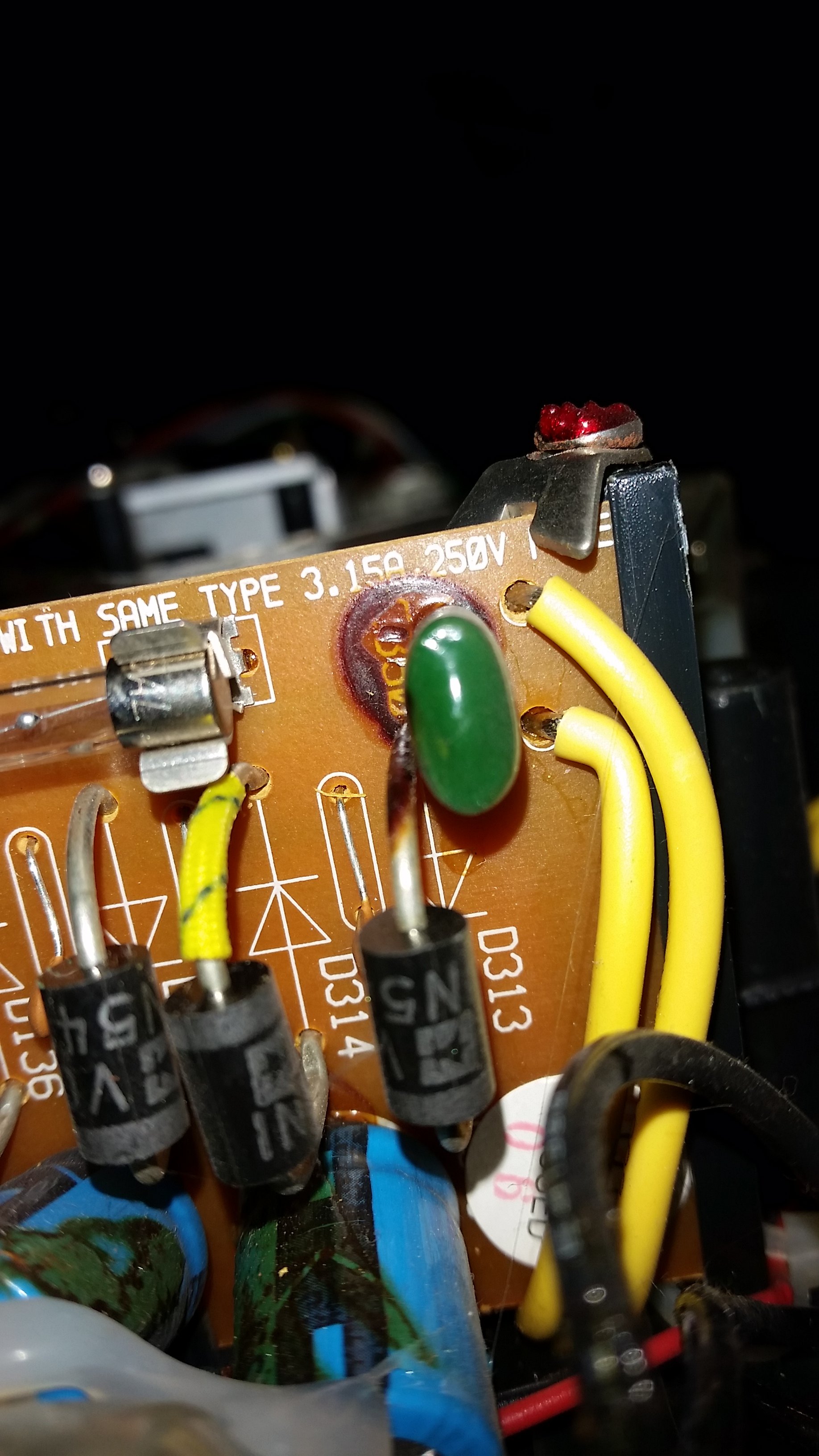

I saw this slight burning near the power board and I think this might be causing the problem.
That's not a "slight burning", that's significant burning. :rolleyes:
I suspect the green component (capacitor?) may be bad.
That burnt component could also be a transient suppressor (MOV?). Whatever, it's likely dead and needs replacing, or at least removing to make further checks. The next question is "What caused it to fail?"
My guess is that the age of this device (16 years) or perhaps too many tripped breakers. The soonest I will turn it on is Saturday 3/5. I have a soldering iron to remove it but I fear that will be the end (of the device) if I do that. I thought you guys might be able to tell what the component was, so it might be a supercapacitor, or transient supressor.
Can you post a picture of any characters on the device?
I don't think it will be a supercapacitor. It looks to be in the power supply area so I think it will be a capacitor or MOV. I SUSPECT the two yellow wires are the AC input to the board. It looks like the component could be straight across the input but you would need to look at the etch side to check. IF this is the case then I think it is more likely to be a capacitor as MOVs are normally on the output side of the fuse. (As they tend to fail short circuit after a large transient.) The markings on the component and the component number on the board would help to identify it. If there is a supercapacitor used supply a cmos memory chip it will be near to the main controller chip.

Unfortunately any of the markings that were on the burnt piece are no longer eligible. Now I suppose I would definitely need a schematic for this device if I am to attempt to fix it. Although the burnt piece is like a green Chicklet there are probably 3-5 identical pieces with different tolerances.
If you have several similarly-coloured and similarly-shaped components then the burnt one is more likely to be a capacitor than a transient suppressor (MOV).
