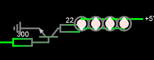

OK Is there any reason why you cannot use 5V for everything?
This will work with PN2222A 's 80 mA out 1.6 mA ini If nec. adjust 300 Ohms for brightness. from 4017 at 5V only 0.5W on 22 Ohm.
Well, yes. I have other circuits that need to be powered off the same source for this project.
This was my original idea to keep the part size at a minimum for space constraints.
Are you suggesting that the 2222 be dangle-biased into operating as a linear amplifier; that is, not as a saturated switch?
All LEDs shud be from same batch for matched Vf.
Are you suggesting that the variation in Vf from one LED to the next will be so small that the corresponding brightness variation will be ok? Assuming that the LEDs do not have internal current limiting, direct parallel LED connections do not work well.
I hope you are aware that when Vcb approaches 0 =Vce is already in partial saturation. > I make use of this fact to operate the device with Ic/Ib=50 rather than 150 when Vce>=2V. I expect Vce =0.7 ~ 1V. This is certainly not precision regulation here and some experimentation to the Rb will be necessary due to the high RdsOn <= 300 Ohms. Apologies for a sloppy design suggestion, erring on the side of cheap parts. I would prefer to push no more than 10 mA to each LED and choose higher efficacy which exists. (10 Cd @ 10 mA) in 5mm. ( I have extensive experience on the limits of parallel LEDs using same batch parts.)
