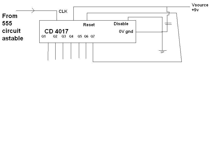

Okay, here's the circuit...
But what's the capacitor's doing in around the CD 4017? :eek:

Every battery powered circuit needs a supply bypass capacitor to keep the supply from jumping around when things like a 555 conducts a brief supply current of about 400mA when its output switches.
Without a supply bypass capacitor then the CD4017 will probably lose its supply voltage for a moment then its outputs will be random.
Use a Cmos 555 (LMC555, TLC555 or ICL7555) to drive the Cmos CD4017. Its supply current spike is much less than an ordinary 555.

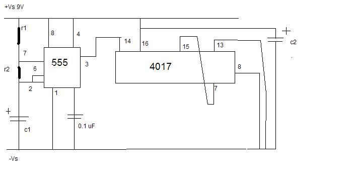

One schematic is better than 1000 words (when it's correct of course) :):eek:

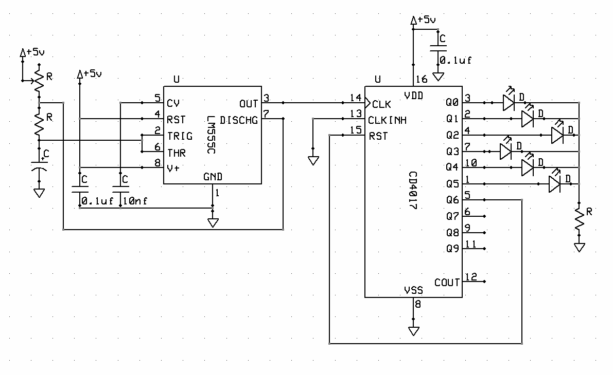

Okay, here's the full circuit! Not sure why my CD4017 hates my current configurations...
Btw... i'm testing it with 3 LEDs first - so I have to connect the pin 7 (3rd count) to the reset. :)

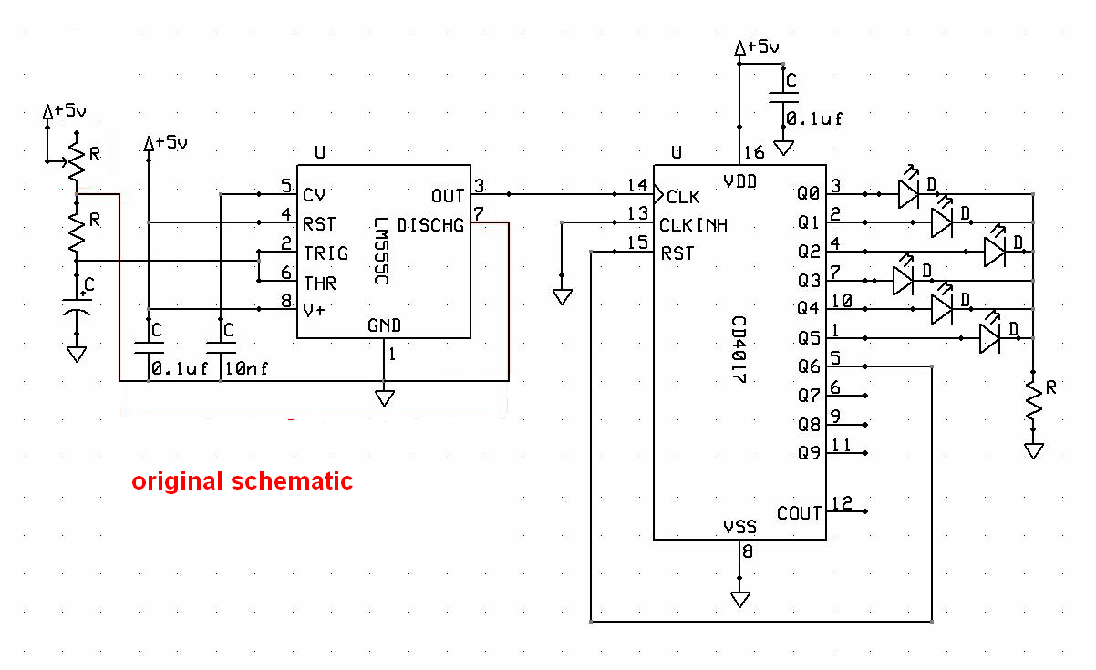

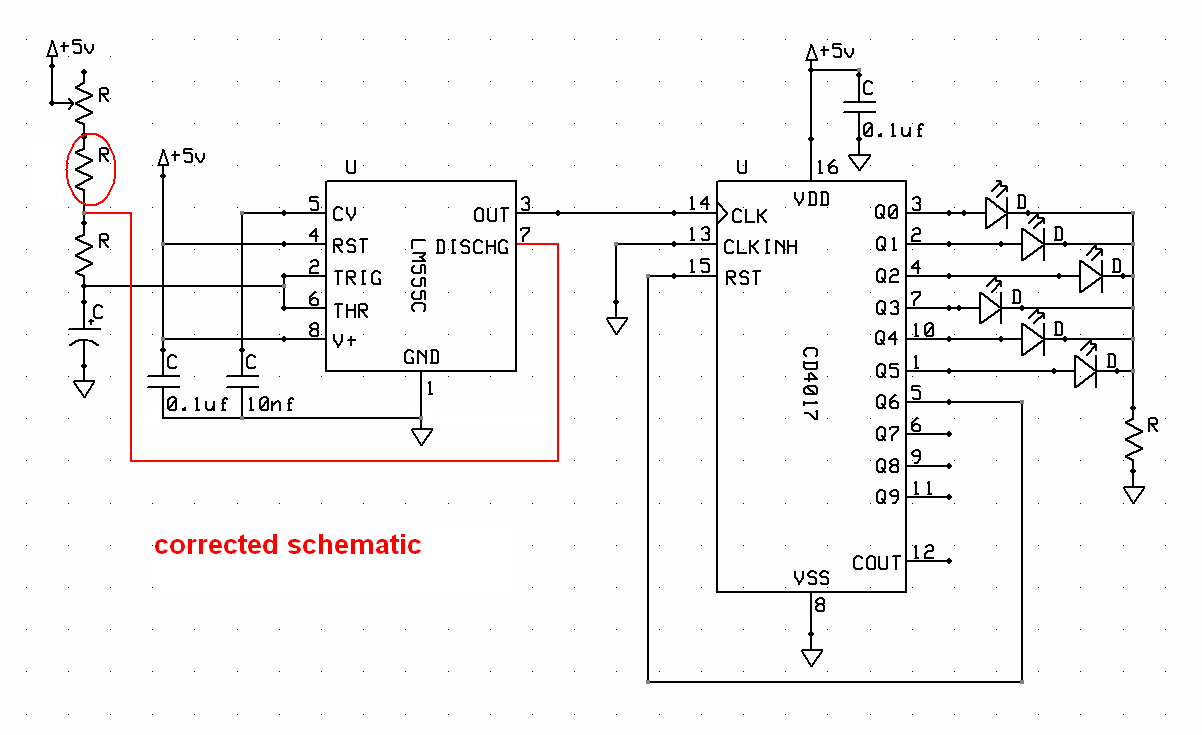

True. I think yours is worth maybe 2 (Oh, crap!). :D

No, pin #6 goes to pin #15
You don't have a supply bypass capacitor at the 555's supply pins. So when its output switches high and causes a 400mA supply current spike, the little 9V battery's voltage drops down to about 5V and the output voltage of the 555 drops down to abput 3.6V which is not high enough to clock the CD4017 that has a bypass capacitor holding its supply voltage at 9V.
