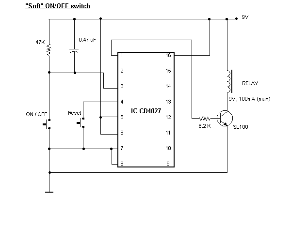

When the "ON/OFF" button is pressed once, the equipment goes on and stays on. It goes off when the button is pressed again. The circuit is straight forward. It uses a JK CMOS FlipFlop to with its JK terminals tied high to achieve the toggling action. The clock is provided by the push button used for on/off action. The resistor and the capacitor near the on/off switch debounces the contacts.
Note that when the circuit is switched on, the relay may land in a on or off state. It can be brought to the off state by pressing the RESET button.
I have tried the circuit in the attachment using electrolytic capacitor, but it is not working. Pls advice if anyone could help me or if there is any other simpler circuit out there.

I see several problems:
1. The maximum allowable clock risetime is 10 usec. Your risetime is nearly 50 msec. You need two Schmitt triggers (CD40106) between your debouncer and the 4027 clock pin.
2. Reset is a logic high level. If you have a normally open switch as shown, you need to connect the switch between +9v and the reset pin. Add a 47k pull down resistor between the reset pin and gnd. If your switch is normally closed, you can leave it where it is, but you still need to add a 47k resistor from the reset pin to +9v.
3. For minimum dissipation, tie all unused INPUT pins on the unused flip-flop to gnd.
4. You need more base drive for your transistor. As drawn, you have less than a milliamp of base drive (remember that the 4027 Q output has some internal resistance). The SL100 has a minimum beta of 40, and this is with a Vce of 10 volts. Beta at saturation (Vce<0.5v or so) will be considerably less. A good rule of thumb is to make Ic/Ib=10. This is very conservative, so you can probably get away with a 1k resistor in the base in place of the 8.2k.
5. Add a 1N4001 diode across the relay coil, cathode to +9v. This will protect the transistor from breakdown due to the flyback pulse from the relay coil that will occur when the transistor turns off.

i would agree that that reset is floating, but you do not need and schmitt trigger because the JK has a schmitt on the inputs. And if he used that SR latch that would not toggle at all :?:

I looked at CD4027 datasheets from 3 different manufacturers, and none mentioned Schmitt trigger inputs. In fact, the maximum clock risetime for a 10 volt supply was 5 usec for 2 of them and 10 usec for the other. This is why I said a Schmitt was needed. Of course, there are other types of Schmitt triggers and even other types of debouncers that could be used.
And you're correct about the cross-coupled NAND latch. It's not a toggle FF, because it requires 2 inputs.
The Reset switch seems redundant to me. You can accomplish the same thing by pressing the Toggle switch. If you want a POWER ON reset, replace the reset switch with a resistor and connect a cap from the Reset pin to +9v. The time constant of this RC combination needs to be considerably longer than the risetime of the power supply voltage.
opps your right i was looking at the HEF family http://www.philipslogic.com/products/hef/pdf/hef4027b.pdf[/url]
and it states: "Schmitt trigger action in the clock input makes the circuit highly tolerant to slower clock rise and fall times."
I agree i think the reset switch is worthless, why not just put a cap there to reset it upon power up no matter what?
I built this exact type of circuit a few weeks ago to toggle a relay, and it works just perfectly, no problems with the rise and fall times as long as it is debounced well.
