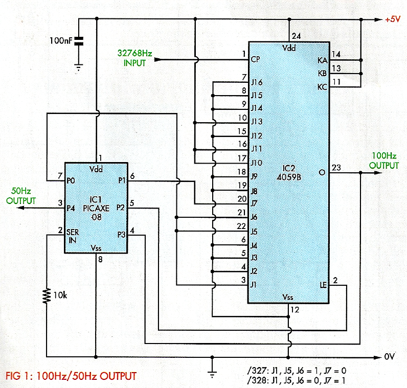

There is a project I did which got published on Silicon Chip magazine, which describes how to exactly obtain 50 or 60 Hz and its 2nd harmonic (in the instance that you are driving a common alarm clock) derived from a watch crystal and utilizing the CD4059 assisted by a small 8 pin micro.

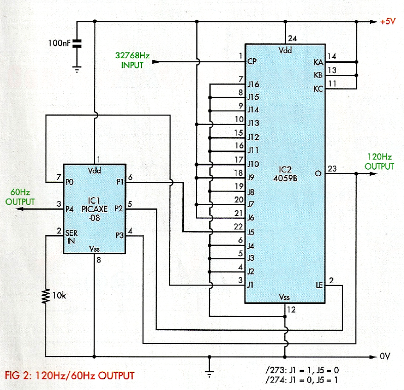

The schematic makes it look like the output of the 4059 is exactly 120/100 Hz, which we know is not correct. Based on nothing but the schematic, it looks like the 60 Hz output is off by 0.16%. As a time of day clock source, that's a steadily decreasing error of over 2 minutes 15 seconds per day. Hmmm ... are you changing between /273 and /274 at something other than a 50/50 duty cycle?
But separate from that - If you have a PIC, why do you need the 4059?
Because to obtain exactly 120 Hz from 32768 Hz, one has to jam the counter for a 273 divisor for 14 periods, and then jam for a 274 divisor for 1 period.
The resulting divider ratio is (273*14 + 274*1)/15 = 273.06666666666 which is the exact ratio what you require.
The microcontroller keeps track of the cycle counts and also divides the 120 Hz to 60 Hz.
In other words, you achieve the required ratio by speeding up and slowing down the counter. There will be some jitter, but for a timekeeping purpose, it is usually of no consequence.
The microcontroller is not a raw PIC but a PICAXE, which runs under a BASIC interpreter.......it executes far slower than a raw PIC does.
Cute trick. Must have been fun working out the ratios. But still, can't the PICAXE do that internally, or are you saying it isn't fast enough to do everything necessary within one input clock cycle?
