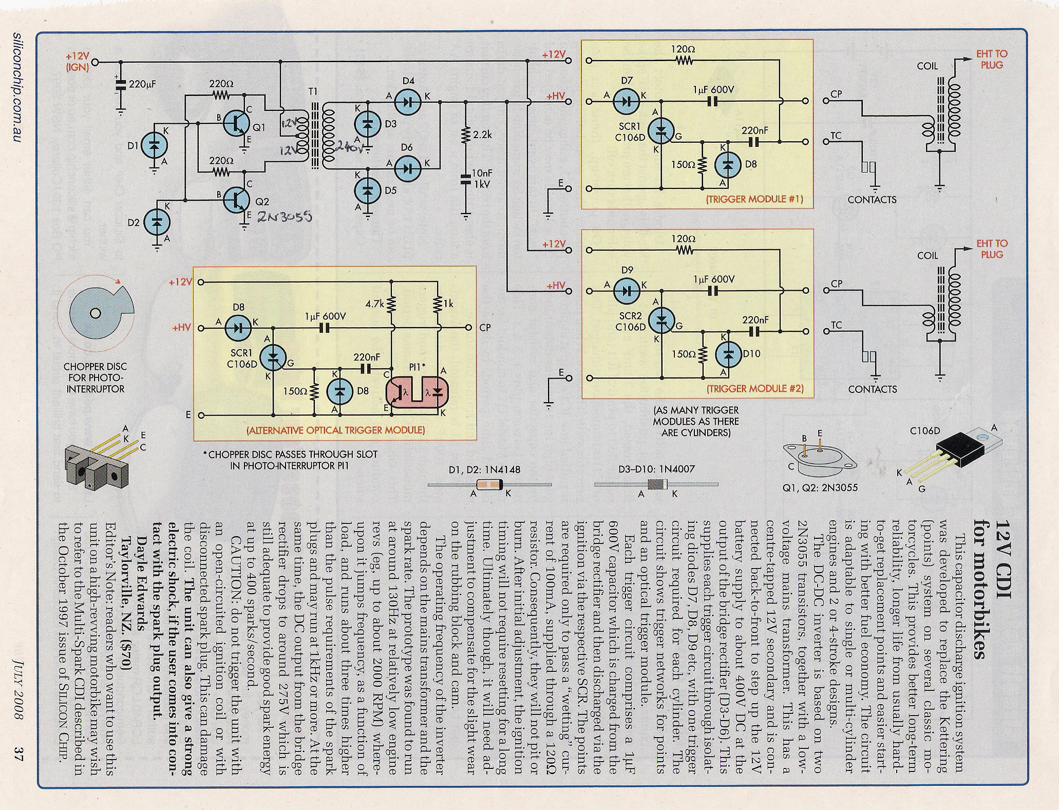

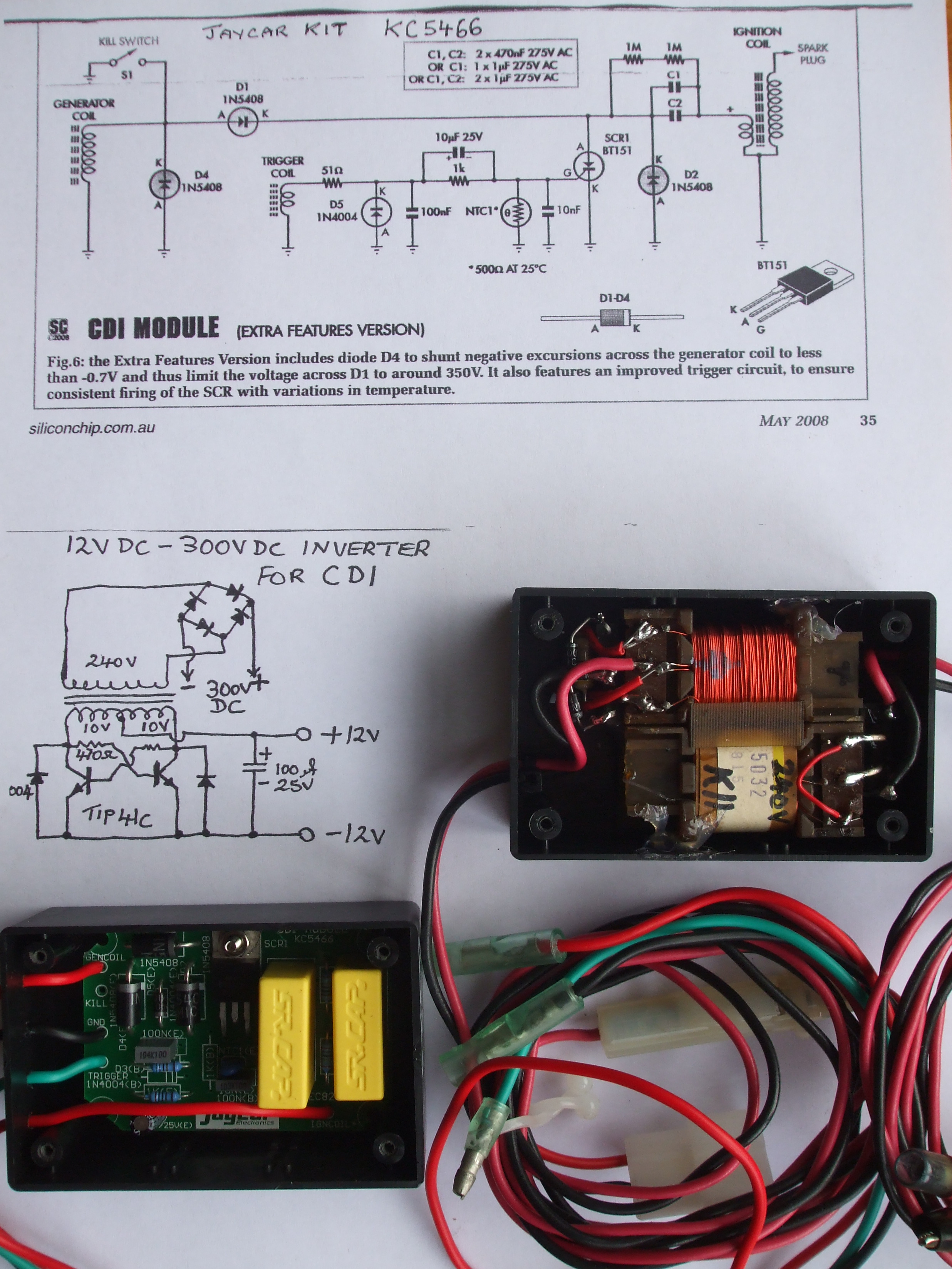

Since you are in NZ, this is a cheep CDI Kit & it works as ive built several for small engines. You will need one for each coil. Not sure about posting the circuit as it may contravine copyright. Its in Silicon Chip magazine May 2008 Replacement CDI module for small petrol engines. Jaycar kit KC5466 $21.95 Au.
Here's the Silicon Chip article. Since it's a simple circuit it doesn't provide any spark advance as the article explains. Don't know what your motorcycle unit did in that regard. Also this unit gets its high voltage from separate generator coil. Don't know if that's compatible with you motorcycle either but I suspect you may need one that generates the high voltage from the 12V battery. Perhaps a unit like this would be better suited.
If it uses a 12V HV setup then this is another option. And its from a New Zealander. You could just use the inverter part of this circuit with the other CDI moule kit.

I guess i can scratch Silicon Chip magazine out because it stating:
This site is no longer accepting subscriptions and only provides access to archived Silicon Chip content for previous subscribers

This will work only one coil, right and i would require another for the other coil. Why would i need the inverter? and if so here would it tie into the jaycar circuit?

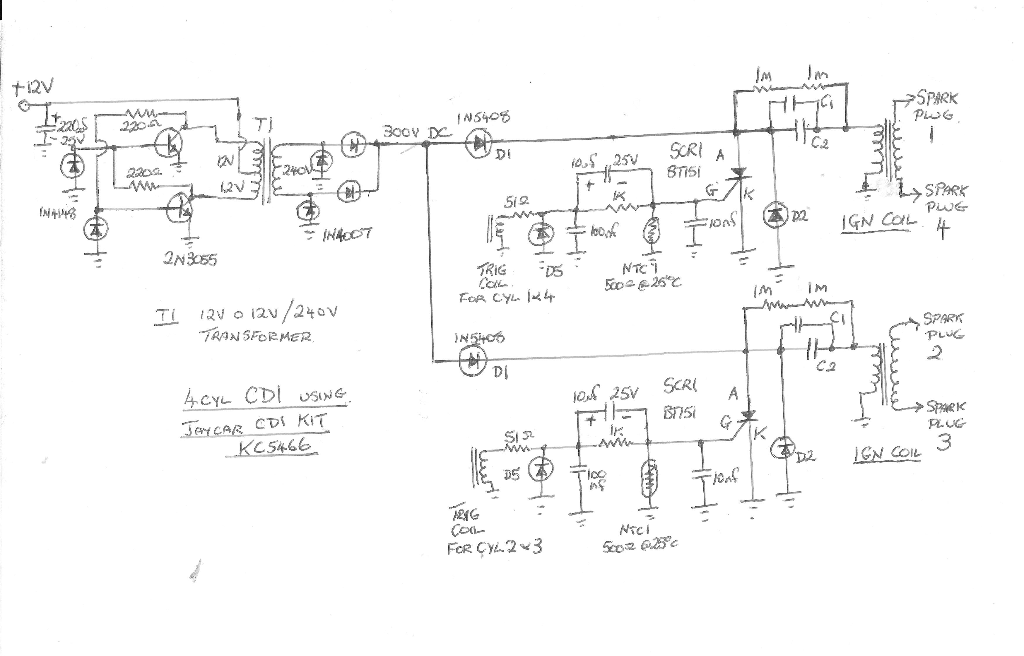

Going by your original post, there is 2 trigger coils in the engine & no mention of a HV coil. But there is a 12V power feed to the CDI unit. The only reason there would be 12V to the CDI unit is for a HV inverter. So for your motor bike to build a CDI unit, it will need a HV inverter to feed 2 CDI modules. One for each coil. It would be similar to post 7. Will draw up a circuit later & post.
Yes, I thought it would look something like that, and thanks for the explanation. Since the Timing Plate is fixed and advance at 36deg, how does the circuit compensate for retard when at low rpms?
