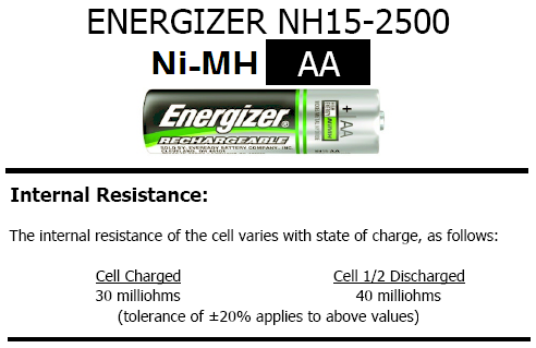

I can't remember which type of battery or what size, but you should look on a battery's datasheet for spec's about it:

the only perpose to measure the internal resistance is to determine the short circuit current ans the voltage out put under a cetain load but these are little practical use
When you know a battery's internal resistance then you can calculate how much its voltage drops when loaded, with any current, not just a short.
Except the internal resistance isn't a constant, and in this case we're talking about CHARGING the battery, and not discharging.
