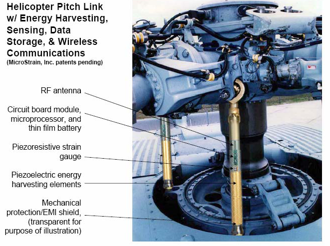

What I found interesting about that article was that someone (ALD) actually makes a device to harvest such low power signals. What do you suppose the use is?
Fully integrated energy harvesting wireless sensors have been developed for the helicopter control rod, or pitch link. Piezoelectric materials bonded directly to the pitch link were used to harvest strain energy for operation during flight. This work demonstrated, for the first time, that an energy harvesting wireless sensor for rotating helicopter components could be operated indefinitely, using only the strain energy of operation for power.
Isn't that just an alternative to an alternator? It still requires energy the heli's primary powerplant.
I know that. I was more curious about whether it was lighter, more reliable, or more efficient than the alternator or hydraulics or whatever other method is normally used to siphon off engine power in order to power the control links.

Found this. I suppose besides the slip rings it would still be hard to get power to the links. I think it is to monitor the health of the system. I suppose with a hammer that big you can get a few micro watts. Not going to replace Hoover dam that's for sure.
