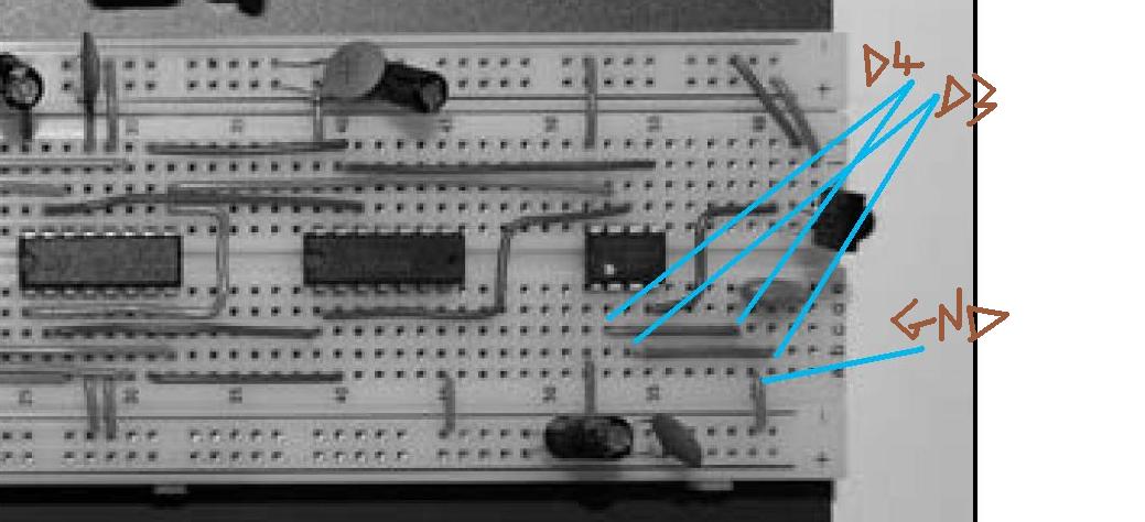

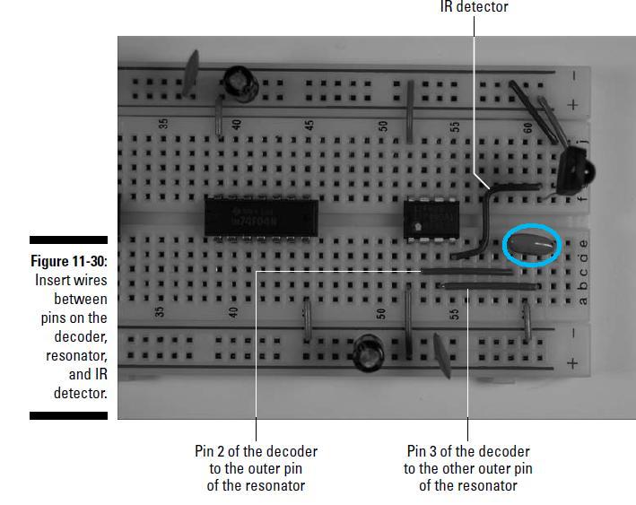

Ok I'm probably being a daftie but I am really struggling to understand this circuit. I've attached a picture of the schematic as I am supposed to build - this picture is using a 5-bit Reynolds Tiny-IR decoder. I cannot find one for sale in the UK so I've using a 4-bit RF600D and RF600E decoder/encoder (from Maplin).
As can be just about seen - apologies for the quality of the pic and the amateurish presentation - the two D3 and D4 lines from the decoder connect to the two outer pins of the ceramic resonator.
So what on earth is this supposed to accomplish when the ceramic resonator isn't connected to anything else?
(I've checked ahead and there are no further lines in circuit plan for any more connections to them).

Thanks for the input but my question is how can the ceramic resonator do anything useful when it has no output as far as I can see. The two lines connecting to it are both outputs from the decoder. The ceramic resonator doesn't do anything useful if it has no output.
You seem to to ignoring most of the replies?, I've already explained to you that it's connected to an INPUT and an OUTPUT, with the centre pin to ground.
If you have incorrectly conected it to two outputs, then it won't work.
Not ignoring, just don't understand. To be perfectly honest, it seems that I am the one being ignored so far lol.

Pins 2 and 3 are supposed to be connected to the outer pins of the ceramic resonator. These are both outputs from the decoder.
I am obviously missing something huge here, please forgive me for that, but I'd really like to understand the circuit.

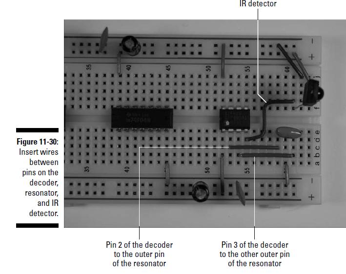

The ceramic resonator has been encircled in blue.
Please also kindly note that the datasheet is for both the encoder and the decoder. The decoder is further down the page.
This is a project from Electronic Projects For Dummies (I am trying to start simple :) ).
It is the 'Controlling a Go-Kart, Infrared Style' project in Chapter 11.
