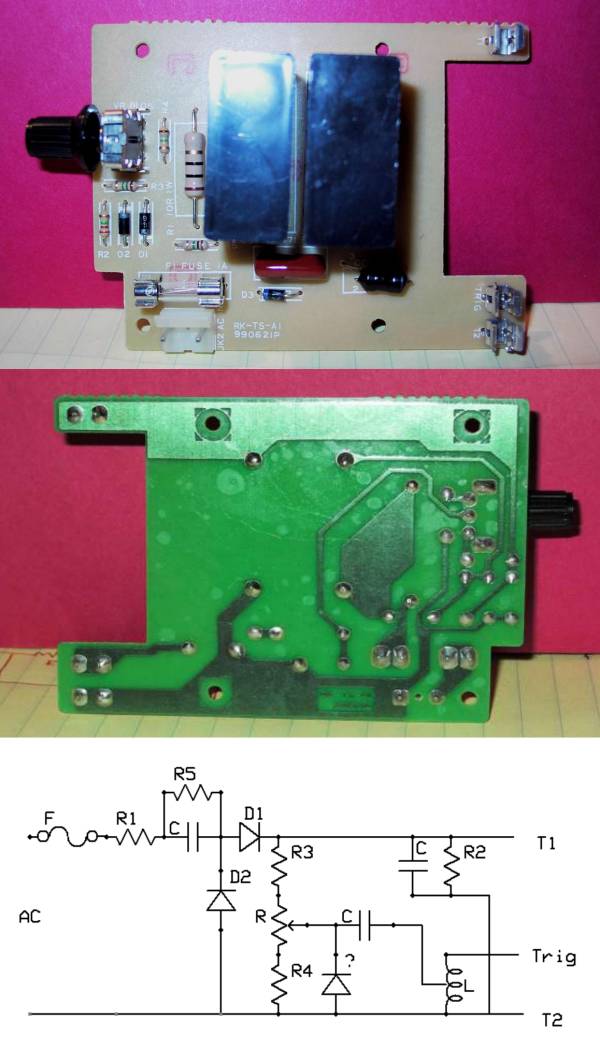

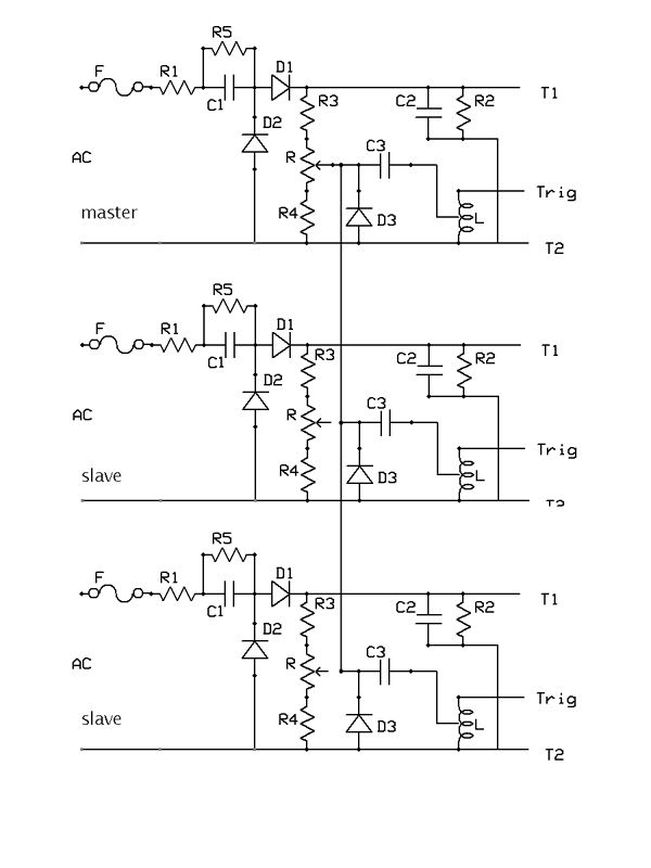

I have 3 of these strobe units and would like to chain them together using one as a master trigger and the other 2 as slave units. I need to chain them by wire. I would also like to change the pulse rate of the master unit from 1-10 pulses per second to 1-20 pulses per minute. What would be the best way to do this? Thanks for all your help in advance. Here's the idea I have for chaining the strobes. since I wanted to change the pulse rate (slower) with c3 on the slaves being charged from the master will this change the pulse rate? will the var resistor on the master be able to handle the load from the 2 slaves? C3 is .o47uf 250v - no clue on the var resistor I would have to pull it to check resistance but I'm not sure on the wattage.
