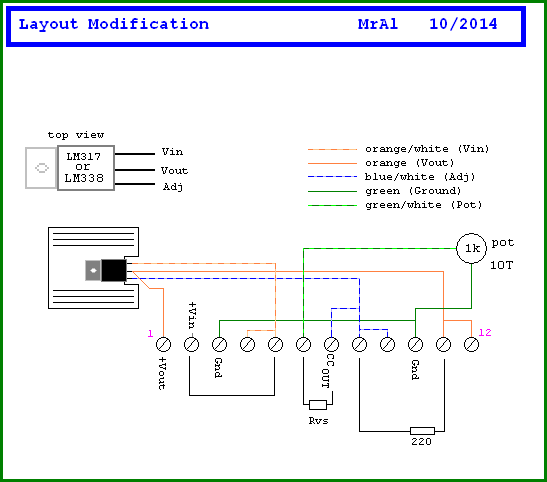

Here is a typical LM317 regulator circuit and layout. Nothing fancy but the layout was done using a screw type connector so that the operation of the LM317 could be changed easily for different functions such as current regulation, so it can be used as a voltage regulator, battery charger, etc., just by changing resistor values and their location on the connector. For this problem however it will only be used in the voltage regulation mode so the RCC is not used and so is open.
The circuit is shown on the top and the layout on the bottom of the drawing.
Some notes about the layout:
The layout drawing shows the placement of the parts. It's very close to real life except the heatsink is vertical.
All the wiring is done with #24 gauge wire and the longest length of wire is 8 inches or a little less, so no wires resistance is more than about 0.020 ohms.
The connections are all well soldered and the screws tight.
RCL is a direct short here, Rvs is around 1.5k but the pot + Rvs resistance totals about 2.3k.
The word "tested" appears at the top corner of the drawing, but it was only tested for use as a battery charger, not (as then) as a voltage regulator.
The heatsink is fairly large, not a tiny one.
Symptom:
Poor voltage regulation with a load like a simple resistive load. With the pot set to create 14.2 volts output (total lower resistance around 2.3k), with only a 1 amp resistive load (connected from Vout to GND) the voltage drops to 14.0 volts. That's way too much for this kind of regulator. The input voltage is 20v DC and well filtered and well regulated.
Can you find the flaw?

I'll add a little more too here...
Since the max resistance of any one wire is really 0.017 ohms, at 1 amp that is only 0.017 volts and even twice that is only 0.034 volts (a run to and fro) so that alone can not account for the drop of 0.2 volts. If you prefer to go with the max of 0.020 ohms then it is still only 0.040 volts which still does not account for the entire 0.2 volts drop at 1 amp load.
BTW with no load it does put out 14.2 volts.

I think that it's a layout problem.
Rcc and the 220 Ω should be connected much closer to the LM317. There is a small voltage drop in the wire from the LM317 to the output terminal, and that is where Rcc etc is connected. That voltage drop causes a current reduction in Rcc etc, and that current all goes through Rvs and the pot. Because Rvs and the pot are much larger resistance than Rcc etc, there is a much bigger voltage drop across them, which is where the real output voltage reduction comes from.
The voltage drop in the wire is being amplified by the ratio of (Rvs + pot)/(Rcc etc)

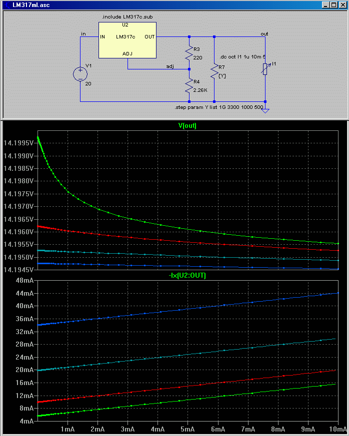

At first I thought that this is a minimum load current problem; you know, the one that Audioguru keeps harping about, were he insists that R3 must be 120 Ohms or lower.
Well, that is a minor contributor, but not the primary problem.
Here is a sim (ignoring wiring resistance) showing what happens if the minimum load current spec for the LM317 is not met. I start with Mr Al's resistors that set the regulator output to ~14.2V. With no external load, the output current -Ix(U2out) is determined solely by 1.25/220 = 5.7mA. According to Audioguru, this should cause the V(out) to be much higher than predicted by R3,R4. See Green traces, which are for R7=1GOhm (open). There is a slight peaking of V(out) for load currents less than 4mA, but this is obviously not sufficient to account for MrAl's problem.
Fixing this is easy. Either lower the value of R3 and R4, keeping the same ratio, or shunt the output with a resistor to keep the min current at -Ix(U2out) a bit higher. The red, lt. blue, and dk. blue traces are for R7=3.3K, 1K and 500, respectively. Note that adding about 5mA to the minimum current from the 317 gets rid of the slight peak. This accounts for my original "add one resistor comment".

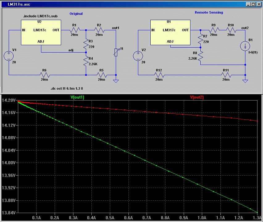

The major problem is wiring layout. The way the original pcb was layed out, the parasitic wiring, pcb trace, and terminal strip resistance ends up inside the feedback loop to the regulator. There are two ways the layout can be improved. One is to connect the top end of R3 directly to the '317 output pin, bypassing R1 (ne R9). The voltage drop across wiring resistance R1 gets multiplied by the ratio R4/R3, so this is best opportunity for improving the regulation.
A second opportunity is to move the bottom end of R4 directly to the output terminal, bypassing the voltage drop across R5 (ne R11), a sort of poor man's version of remote sensing. This only improves the regulation 1:1.
A before and after sim comarison is shown: You can see the slight peaking at low load currents caused by not meeting the min. load current, too.

First, this was a real life problem that i discovered in my power supply just recently because i wanted better regulation than i normally need with battery charging, because with battery charging i dont mind if the voltage is a little lower to start with and then picks up later when the current decreases.
Second, it's not really about the 220 ohm resistor 'value'. True it should be lower, but keep in mind that the min current spec is not a cut and dry spec it's a "to be sure over all temperature and specific part selections" min spec which means some regulators at some temperatures (like room temperature) will operate pretty much the same with either a 220 ohm, 150 ohm, or 125 ohm, or 120 ohm, except of course for the choice of R2 which also has to change to maintain the same output voltage. That said, changing the 220 ohm to 100 ohm (and R2 to the appropriate value) does not change the result as it still drops by 0.2 volts from 14.2 to 14.0 as before. However, 100 ohms will be used for the remainder of this discussion when a calculation is made but not in the schematic diagrams where it is still shown as a 220 ohm.
Third, those who stated that the problem had something to do with the layout where the physical layout position of the 220 ohm resistor with respect to the TO-220 package where correct, at least in part, and for the most part, correct. I'll explain next.
Those that said that it was a 'single wire' that was the problem were absolutely correct but this is very close to the same reasoning as the physical location of the 220 ohm resistor so the two ideas are almost the same. I'll explain next.
The main problem:
The main problem is that the wire connected to the center pin (Vout) is SHARED between the 220 ohm current AND the load current (see where Vout is taken from pin 12 of the connector). That means that any current that flows through the load also flows through this wire. Since the wire gauge is #24 AWG and the length is about 8 inches long, that puts the resistance of that one wire at close to 0.017 ohms (just 17mOhms). That is not much, and at 1 amp there is only 0.017 volts drop in that wire, which is not much. If it was just that, it would mean the output would drop by only 17mv which would not really be as much of a problem except in the most extreme cases where we need super great regulation.
But the problem is that it also drops the voltage getting to the 220 ohm resistor, and that is the resistor that should have the internal reference voltage across it at all times in order to ensure good regulation. Comparing the 17mv to the 1.25 internal voltage drop we get:
0.017/1.25=0.0136
which can be read as "1.36 percent" of the reference voltage, which still doesnt seem like much but considering this regualtor should be at least as good as 1 percent OVER THE FULL TEMPERATURE RANGE, that means we might expect another 1 percent drop which would be nasty.
But how this affects the output is quite astonishing. Since we experience a 1.36 percent drop in reference, we can expect a 1.36 percent drop in output, which means the output could drop to 100-1.36=98.64 percent. Starting with 14.2 volts that means we have as output:
Vout=14.2*0.9864=14.00688 volts !
Now we see how big a deal even a small resistance like 0.017 ohms can make in the output voltage.
The real equation is like this:
Vout=(Vref*(R2+R1)*RL)/(R1*RL+Rs*RL+Rs*R2+Rs*R1)
where R1 is the upper resistor (like 220 ohm or 100 ohm) and R2 is the lower resistor, and
RL is the load resistance and Rs is that pesky series resistance between the Vout terminal and the 220 ohm resistor when the load is drawn through that same resistance. Also, Vref=1.25 volts or close to that.
If we solve that equation for Rs, we get about 0.017 ohms, which is the resistance of that one wire.
I should also point out however that the real problem is that the one wire is SHARED with the 220 ohm current and load current. That's the real problem. If there were two individual wires, there would be no problem because then the 220 would have it's own wire for current so there would be no drop. This means the resistor itself does not have to be moved, we just need to add a new wire from Vout to the load so that any load current drops a little voltage but only in that wire not the 220 ohm resistors wire.
The fix then is very simple as many here thought: just add a separate wire to Vout that goes to the load.
The fix is shown in the new diagram, where the connector terminal 1 was disconnected and instead used for the LOAD connection for Vout (see attachment). Note i removed some of the resistors that were not being used anyway for this.
