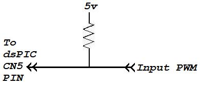

Dear All,
I am working with the change notification CN pins of the dsPIC30F30. Even though, I am giving a PWM signal as input to the CN5 pin, I am not getting any response from the CN ISR. Please take a look at my code & circuitry and let me know if there is anything wrong there.
void InitICandCN(void)
       TRISB = 0x38;             // Ensure the CN pins to be input
       CNPU1 = 0;                 // Disable all CN pull ups
       CNEN1 = 0x20;            // Enable CN5
       IFS0bits.CNIF = 0;       // Clear interrupt flag
       IEC0bits.CNIE = 1;       // Enable interrupts on CN5
       return;
void __attribute__((interrupt, no_auto_psv)) _CNInterrupt (void)
       SendData('U');                // Sending data to PC using UART communication
       return;
I am using the attached circuitry.
Thanks in advance
NB: My SendData function works properly, I checked it in other ways
Are other interrupts working? Do you have Global Interrupt enabled?
Have you tried polling the pin to verify that you can read state transitions?
