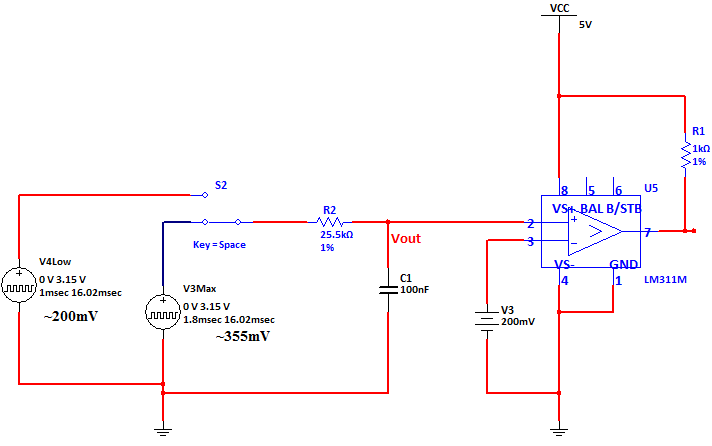

Ok so I did a quick simulation in multisim and created the low pass filter with cut-off at 62Hz and using the lm311 comparator.
The only problem is that I'm not yet able to switch the output as I described before.
When V3Max is the + input to LM311, the voltage is 355mV and when V4Low is the + input to LM311 the voltage is 200mV.
I'm close to getting this working, but the output from LM311 doesn't witch from 0-5V output when I toggle the switch.

If I read your schematic correctly you only have 3.15 volts for the input signal. If that is true you may need to stay with the comparator. What you have now should work.
Yeah, What I have is only 3.15V. The circuit works ok in the sim, but there seems to be some jitter at the output for a few milliseconds before the output CMND complety changes stare. How can I get a smoother transition? I'm trying to get a smooth signal like alec_t posted on his wave form.

Try adding some positive feedback (3.3 meg?) from pin 7 to pin 2 of the comparator.
I simulated your circuit with added +ve feedback, but reliable jitter-free 2-way switching wasn't achievable. The jitter is due to the ripple on the waveform at the comparator input. The problem is that with simply smoothing the PWM signal (your circuit) instead of using a leaky rectifier (my circuit) the difference between the average voltage for the 5% and 12.5% PWM ratios is so small; less than the hysteresis provided by the feedback.
PWM Filter
The hysterisis needs to be larger than the ripple. So you need a lower frequency filter and more hysterisis. Try these values.
Thanks ronv, that did the trick. I'm not familiar with comparators, but this really helped be out. I found an LM393 and built the circuit. I will play around with inverting and non-inverting. You might have seen my other post need-help-switching-signals

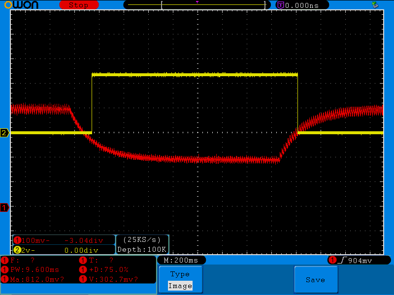

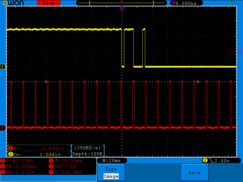

I've attached an image of the results from my actual circuit.
I also added an image with feedback resistor removed.

Cool. Is the long time constant ok for your purpose? It takes almost 1/2 second to make the step.
Is this for a plane or something else?
It's actually around where I need it, might need to play around with it when I'm a little more advanced on the project and during testing.
