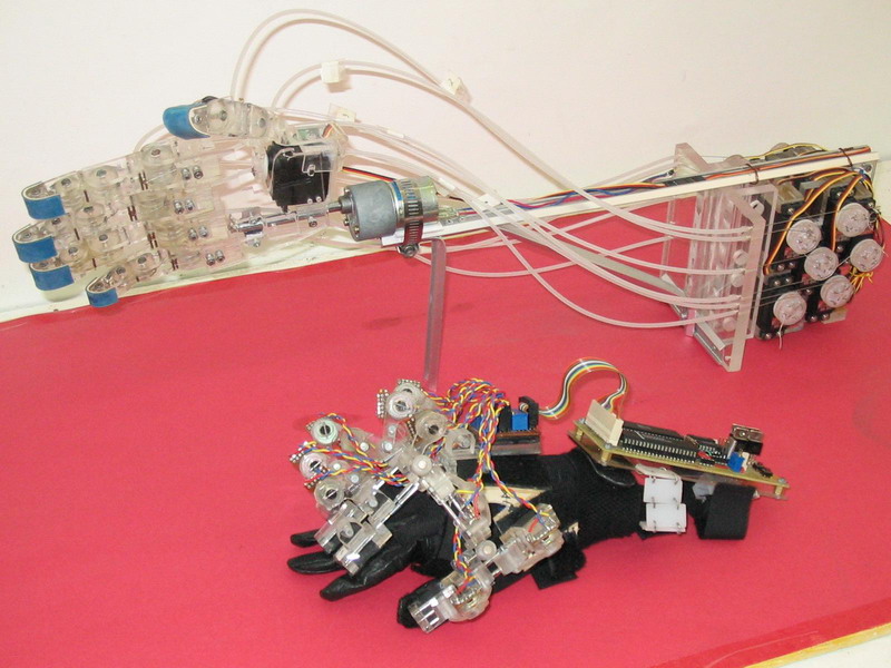

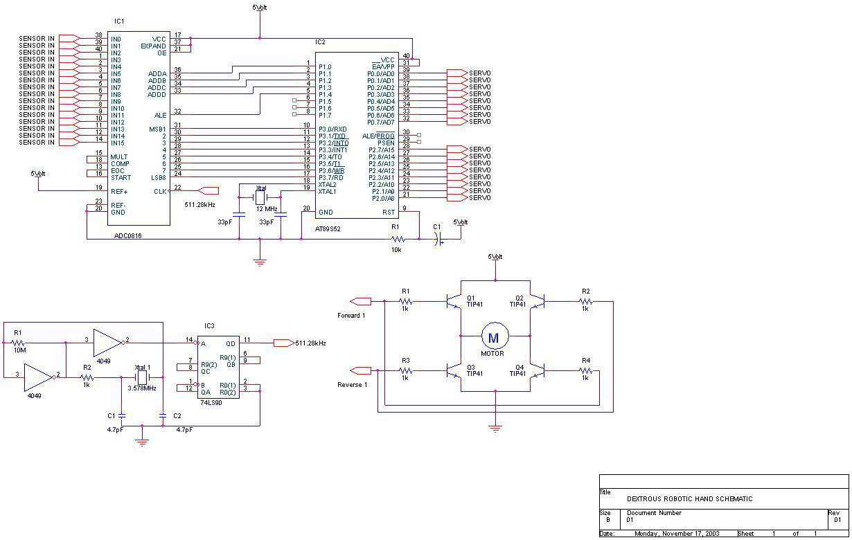

I found this site which satisfies everything i need for my project but the only thing is tht instead of using connecting to a PC i want to give the values from a ADC. i am posting the site and the codes can u plz help me editing it aacording to the circuit diagram in the next post
and also i will be using 5k ohm potetiometers as sensors in the circuit if any other sensor is better plz help me

heres wat i need to change it too

Port 0 isn't going to work very well without pullup resistors. Where do all the identically name nets called "SERVO" go to. Where do forward and reverse come from. You gotta a lota work to do.
Papabravo
the forward and reverse are for another gear motor for the wrist and the servo names go to servo motors control pin as pwm signals
