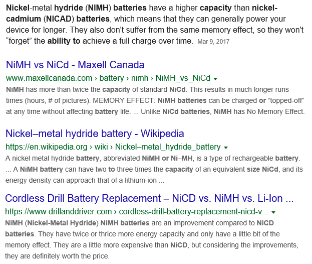

You got it backwards. A Ni-MH cell has much more capacity than a Ni-Cad cell the same size.
I guess people are not buying high capacity and high cost C and D size Ni-MH cells any more so Energizer has the same capacity for them as a little AA Ni-MH cell. I think a modern Ni-MH AA cell has the same capacity as an antique Ni-Cad C or D size cell. But I could not find spec's for an antique Ni-Cad cell to prove it.
In Google, I selected articles that show a Ni-MH cell beating a Ni-Cad cell but there are other articles saying that a Ni-Cad is better than Ni-MH when the current is extremely high, when the temperature is very cold or is very hot and when a cell stays discharged for a long time.
