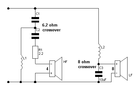

I've been given a pair of Celestion PA speakers, with duff bass units. The only problem is that they are 4 ohm, and 8 ohm would be much better for me! (and I can get some 8 ohm Celestion bass units at a decent price that will drop straight in).
I'm attaching the circuit of the crossover below, now what I want to know is if I replace the bass unit with an 8 ohm one (and change L2 and C3 accordingly), could I just change R1 to 6.2 ohm and keep the respective levels between HF and LF the same?.

Hi Nigel,
Instead of replacing the tweeters with 8 ohm ones, connect the 2.2 ohm resistors directly in series with them and design a 6.2 ohm crossover. You're going to replace the woofer's crossover parts to match its 8 ohms anyway. :lol:

MStechca,
Replacing the 4 ohm woofer with an 8 ohm woofer results in half the power, which is a loss of 3dB.
If you put a 4 ohm resistor in series with the 4 ohm tweeter then both the voltage and the current is halved, resulting in a loss of 6dB.
The 2.2 ohm resistor in series with a 5.31 ohm tweeter would result in a loss of exactly 3dB. Since the tweeter has inductance and since it is crossed-over at a frequency higher than its minimum 4 ohm rating, then it most likely is close to 5.31 ohms at the crossover frequency.
Quality speakers use a series capacitor and resistor across the speaker drivers to cancel the inductive rise of their impedance with higher frequencies, and the resulting known impedance is used when calculating parts for the crossover.

OK, I've had a play with a sinewave generator and a scope!, the crossover frequency actually measures around 3KHz. I've tried adding a 3.9 ohm in series with the existing 2.2 ohm, and it doesn't seem to cause any problems?, the crossover is still at the same frequency, and there doesn't seem to be any ill effects as I slowly sweep the frequency, it looks just the same as before (except smaller of course).
So for an initial try I'll just get a pair of 8 ohm bass units, alter the bass crossover, and change the 2.2 ohm for a 6.2 ohm, and see how they sound.
Bear in mind it's for PA, not HiFi, so a flat response isn't a great requirement.

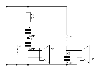

Hi Nigel,
I'm a perfectionist. There are two ways to do anything, the correct way and the "other" way.
The original crossover had its tweeter attenuator resistor ahead of the filter which ruins the Q of the filter. The tweeter attenuator should have been after the filter then calculated for the series impedance. An L-pad (resistive divider) could have been used to adjust the tweeter level without changing the crossover parts.
This crossover circuit is common:

audioguru said:
Hi Nigel,
Have a look at , which is a Celestion design for a very similar 8 ohm PA cabinet, and it has a 10 ohm series resistor before the filter 8)
Yeah, Celestion are good guys. They must have had a good reason to do it their "other" way.

I've downloaded SwitcherCAD III so I can try simulating the crossover!.
So I've been having a play (I've also measured the values of the inductors in the existing crossover, as I realised one of my multimeters has an inductance range - that I've never had occasion to use before!), the bass inductor reads about 0.6mH (presumably 0.64mH?) and the treble inductor reads about 0.08mH.
I used the simulator to plot the outputs of the crossover into simple resistive loads, with the original values. I then changed the bass unit to 8 ohms, doubled the value of the inductor, and halved the value of the capacitor, and ran the simulation again - the plot was essentially identical (as expected).
I then tried changing the 2.2 ohm feeding the treble filter to 6.2 ohms, and ran it again, as expected the level dropped somewhat, but the filter function didn't change appreciably - so I'll probably try it like that and see what they sound like.
In both cases the tweeter shows a large peak around 200Hz, presumably this is partly due to using resistive loads, rather than actual speakers?, I couldn't see any speaker components in SwitcherCAD III - not that I really knew how to use it :lol:

Hi Nigel,
My speaker and crossover design software is on the broken hard drive of my old computer. The shareware programs I used are now pay-per-use.
But I recall that in a Butterworth 3rd-order highpass filter for a tweeter, the capacitor's value to the tweeter is a little more than 3 times the value of the one from the amp. In your crossover the capacitor values are equal so I don't know what the response would be.
Sure, try it by just changing the attenuator resistor. :lol:
Funny you should say that!.
The Celestion link I posted uses 3uF and 8uF (at 8 ohms), yet the one in the Celestion cabinet I have here uses two 4.7uF (at 4 ohms) - presumably it's down to the actual tweeter used?.
I wonder if the final values were arrived at with acoustic tests, rather than calculations?.
