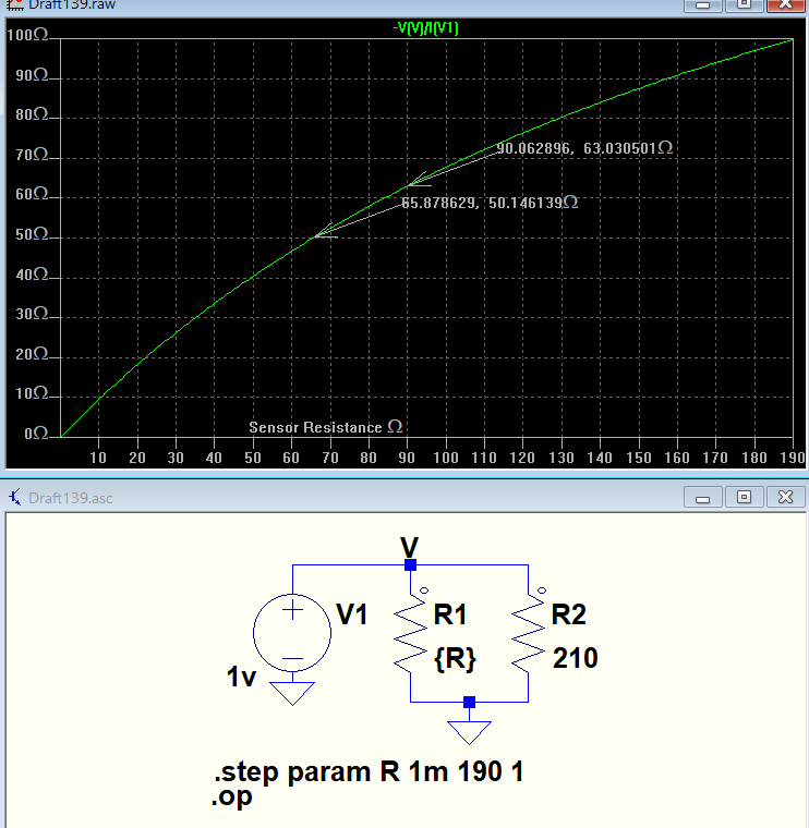

To reduce the 190Ω to 100Ω equivalent, add a 210Ω resistor in parallel with the fuel sender.
The main negative to that, is it will make the gauge reading somewhat nonlinear.
The LTspice simulation (below) of the two resistors in parallel shows the parallel resistance (vertical scale) versus the sensor resistance (horizontal scale).
As you can see, a tank half-full sensor reading (90Ω) gives a parallel value of 63Ω to the gauge, whereas 50Ω is gauge half scale.
The half-full gauge reading will occur at a sensor value of 65.8Ω or about 35% full.
So the gauge will read some high when the tank is between full and empty.
The full and empty readings will be okay, of course.

All tanks are non-linear because the cross sectional area is not the same at each level of fullness. Your solution is more than accurate enough for a fuel tank. Every car I've owned, I've gotten fewer miles in the second half of the full gauge reading than in the first half.

Thanks, that's really helpful. I have found a 210k resistor that is rated at 3w, I'm presuming that will be ok?...

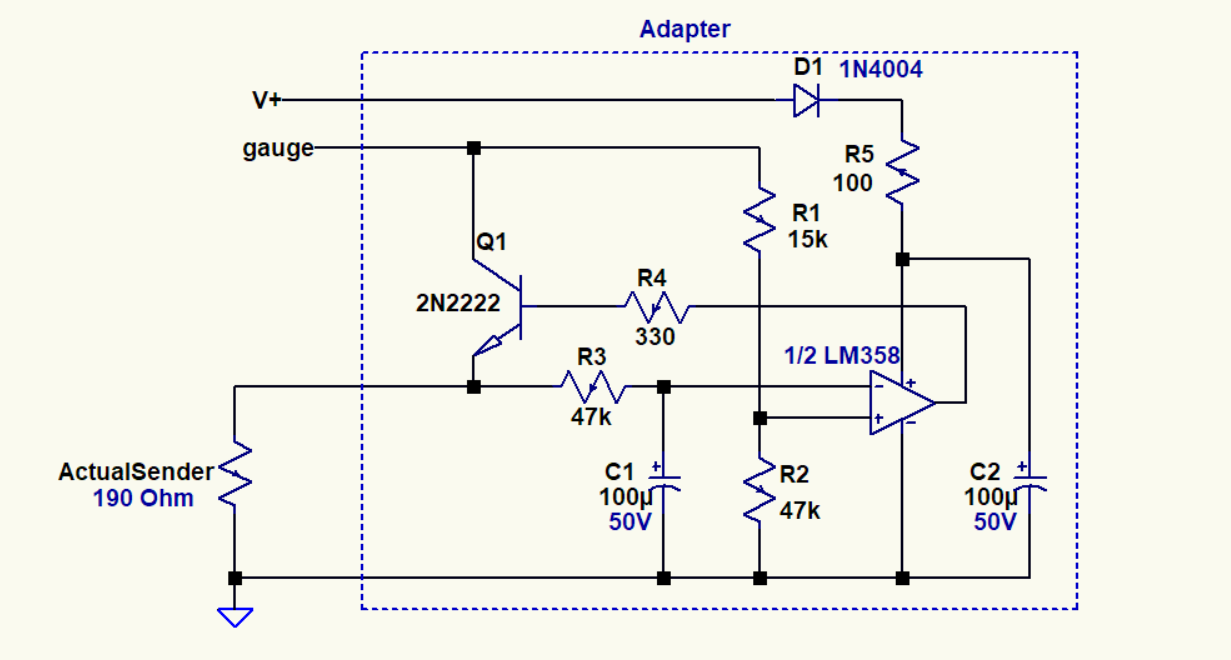

Here's a circuit which uses an actual 0-190 Ohm sender and simulates a 0-250 Ohm sender.
