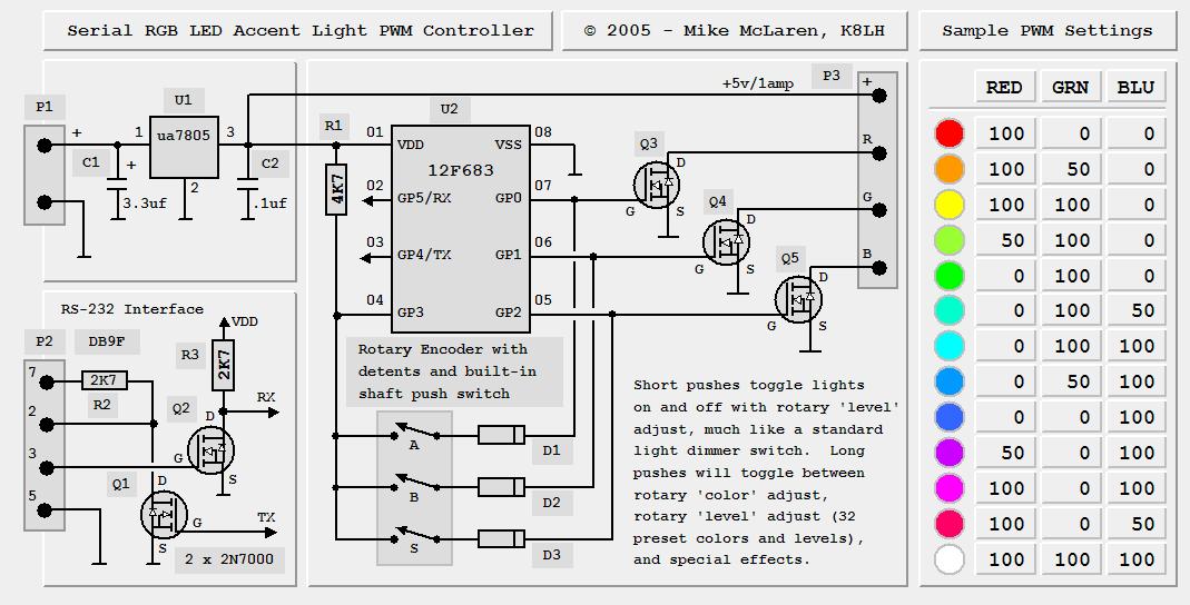

Howdy neighbor,
I've done something similar (though never finished) using an 8-pin 12F683 running on the 8-MHz INTOSC...
There's many many different ways to accomplish the task and your method is probably as good as any other...
I used TMR2 generated 104-usec interrupts (every 208 instruction cycles) for bit-banged RS232 serial I/O and included the RGB PWM counters in the ISR as well... Each interrupt cycle I would increment the cyclic PWM period counter (cycling from 0 to 100) and compare it to the three Red, Green, and Blue PWM duty cycle counters (each set to some value between 0 and 100), turning an LED off with a counter match...
If I were to add blink control, I think I would just setup another counter in the ISR to count off 250 interrupts and toggle a 'blink' flag bit or mask for the RGB output pins (or to flip TRISIO bits)...
Kind regards, Mike
