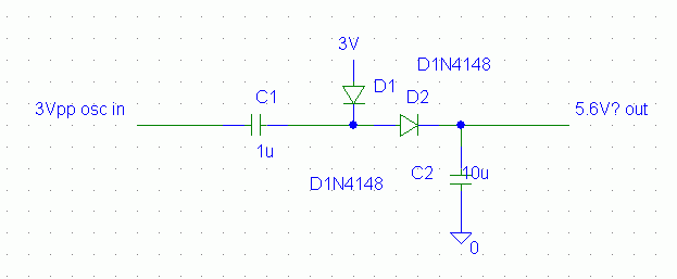

assuming you're using a ucontroller: if you have a spare output pin (one of the PWM pins would be simplest) you can make a capacitor multiplier with a couple of diodes and caps. The lcds generally only draw a mA or so
The current through a cap is I = CVf
But I think you'll find it easier to just run a sim or do some trial and error until you get an output with the right voltage and sufficiently small ripple. Increasing the frequency will allow for greater output current, but will be limited by the IO pin output drive capabilities.
Circuit attached for reference.

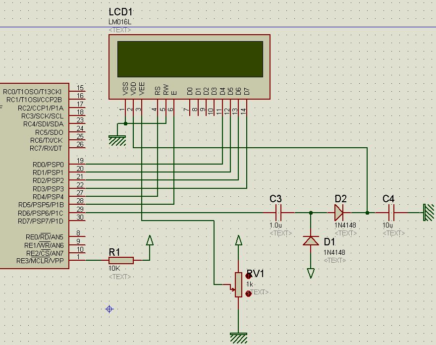

heh yeah im toggling from RD6.. on actual circuit it turns my 2.5 volt to alittle above 5 which is awesome!!!!
But i need to get a new pot for contrast control.. for some reason my doesnt work using this meathod. I assume because the current is less anyway. heh i have a 5k pot i think. ill get a 100ohm or something heh thanks alot i learned something new :D
Here is my schematic so far. But in real work LCD doesnt work because of contrast heh
(i think its the resistor (POT) tho)
boost-jpg.34594
Is the pot drawing too much current from the 5v supply?
