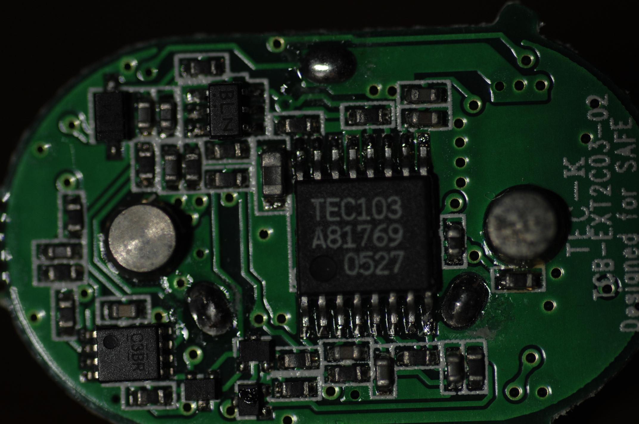

I have one of these charger things floating around somewhere I'll track it down and take some photo's of the circuitry, unfortunately I'm not good enough to identify everything lkely to be on it and so cannot give you a schematic diagram.

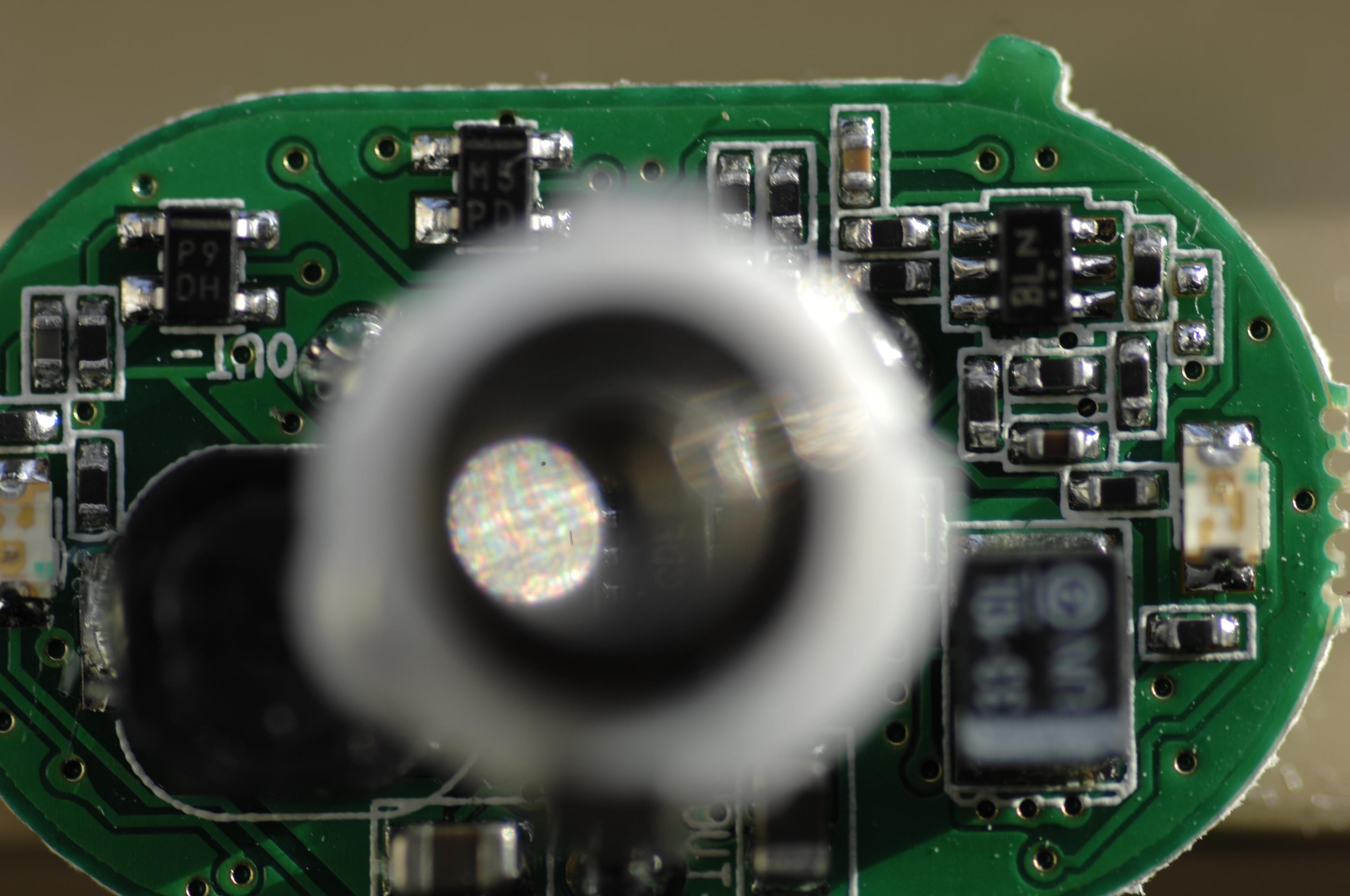

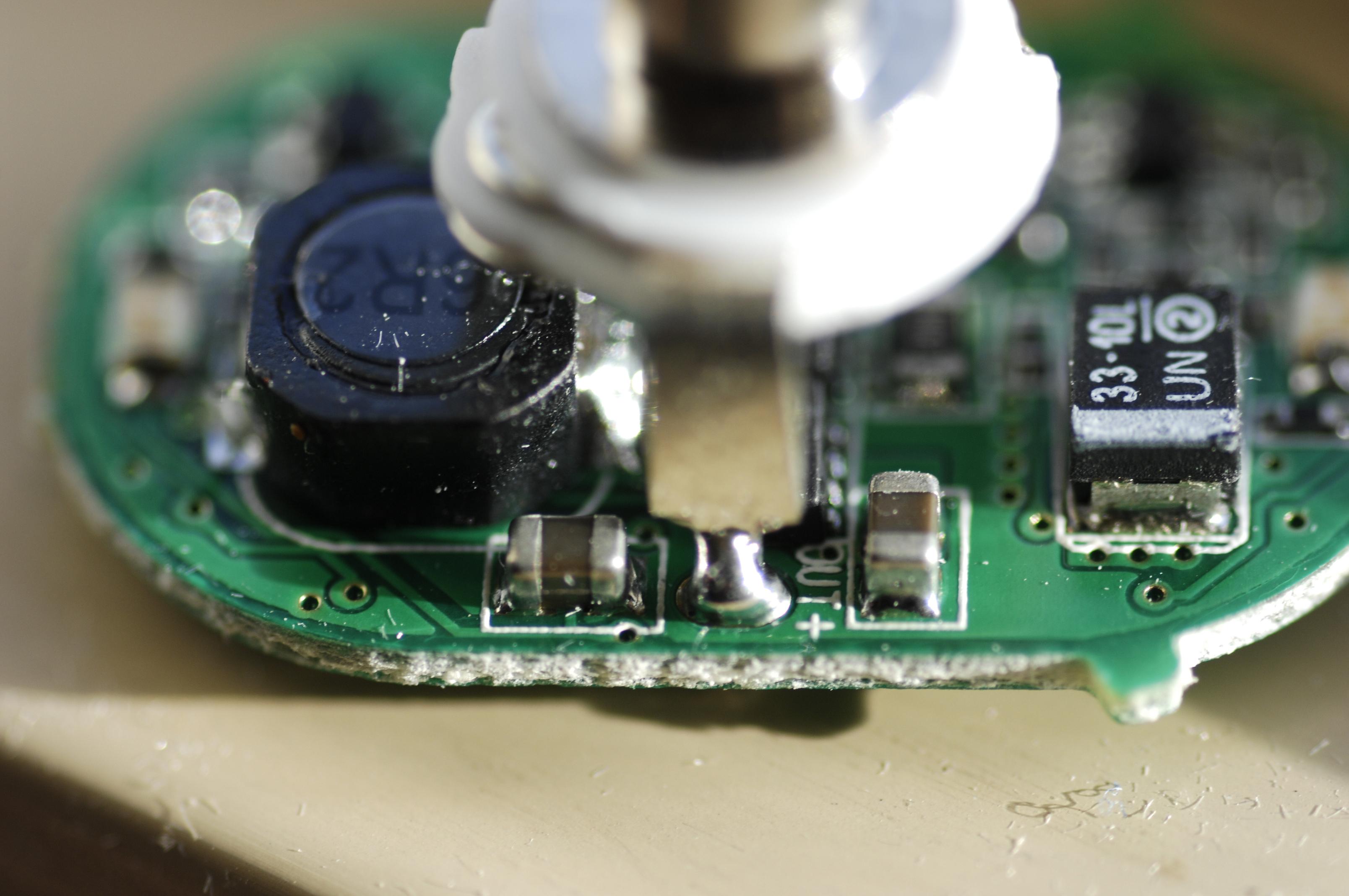

Best images I have at the moment.
Here are the best shots I could get with a D2X DSLR
I'll try using a phonne camera to get in under the jack but no promises.
There you are if you want more I can try and get them.
