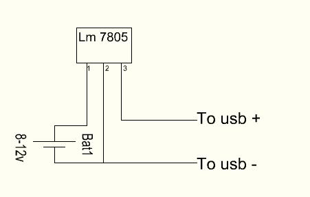

I would connect a 7.4V~11.1V LiPo battery pack to the miniUSB port (5V - 1.5A max) of my cellular phone to power and charge it.
I want the circuitry to be as small/light as possible since I would like to keep the whole thing in my pocket.
What solution do you suggest?
Well Firstly be very careful when conecting circuits to an expensive phone. and don't try this circuit till one of the expert people here say its ok :D

You need a low-dropout voltage regulator since your battery is as low as only 7.4V.
Voltage regulators need the input capacitor and output capacitor that are shown on their datasheet.
You need a circuit to disconnect the Li-Po battery when its voltage becomes too low or it will be destroyed. It might even catch on fire.

I read that the LM7805 is a linear regulator and linear regulators dissipate the "voltage in excess" in heat. That would be a bad use of my LiPo battery and dangerous for my pocket. Isn't there a better solution?

I heard that if a switching regulator fails it lets the input voltage pass entirely and this would fry my phone.
What happens if a low-dropout regulator fails?
Ah, thanks for remembering this to me! What do you suggest me to use for this?
I have used many low dropout regulators and have never had one fail.
It could go dead, it could short the input to ground then the Li-Po battery will catch on fire or it coud pass the input directly to its output which will also set the battery on fire.
An ordinary regulator could fail the same.
