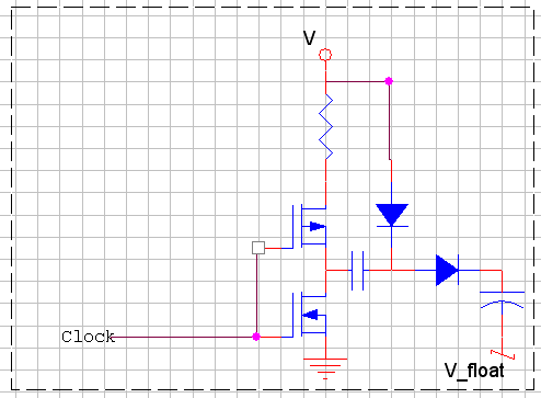

I'm making a charge pump to provide a floating supply (to replenish the boostrap capacitor for the high drive MOSFET so it can maintain continuous gate drive).
I can use a 555 timer or some isolated charge pump circuit IC from ONSemi, but they all require a few too many components and I'm running out of room and need a few of these lying around the PCB. I was thinking I can cut out the timing capacitors and Vdd/Vss pins normally required on such ICs if I just use a CMOS pair and use a pin from the uC as the clock instead (please see diagram).
I only have one pin to implement this on (no software controlled dead-time), and it would somewhat defeat the purpose of minimizing components for this anyways if I used two pins. It would also very obviously defeat the purpose if I used gate driver ICs with dead time. So, I was thinking I could just place a resistor on the source of the PMOS to deal with shootthrough. I don't think any current realy flows through the PMOS- it's just used to float the capacitor to charge the floating cap.
Does anyone see a problem with this?
EDIT: Oh wait, the current that transfers charge between the caps passes through the resistor. Hmmm. ANd splitting the resistor between high and low side ends up speeding up the charge transfer a bit while slowing down the charging of the capacitor that gets boosted up. Does anyone know of a realy simple way to get around this? Maybe I should just size the resistor appropriately?
How do 555 timers deal with shoot through in their push-pull circuits? I'm pretty sure they don't have anything like that but I could be wrong.

I'm not sure what you're trying to do, but here's the things to keep in mind:
1. The NMOS and PMOS transistors have an internal diode
on the drain-source which is reverse-biased in the "normal" direction. Any time the Vds is substantially (>0.3V to 0.7V) negative in an NMOS or
positivie in a PMOS, this diode will conduct.
2. The flying cap must form a complete circuit to charge or discharge. I am unsure of the completeness of this circuit as the nature of V_float is not adequately depicted.
Sorry, didnt notice that it wasn't clear. Vfloat=V in my case.
Yeah, I was thinking about problem about the diodes too (though when thinking it through I didn't seem to see any times they might conduct). BUt these diode problems along with shoot thorugh, don't they also exist for the push-pull in a 555 timer? I've never heard of anyone running into these problems with a 555 timer.
This is meant to try and replace the 555 timer charge pump on page 18:
https://www.electro-tech-online.com/custompdfs/2007/12/an-978.pdf
I'm basically trying to get rid of the timing resistor and capacitor.
EDIT: Well, it seems that whatever I do to try and get rid of shoot through will need more parts than just using a 555 timer and someting as simple as resistors brings it down to the current capacity of the 555 timer in the first place. So unless I can ignore shoot through for some reason, I guess I'll go with the good old 555.

It's okay, thanks. I Just realized I can't ues a uC for the clock because the whole thing (as shown in page 18 of the app note I posted earlier) has the negative supply of the whole charge pump is referenced to the motor battery voltage (rather than the positive supply being referenced to ground)- that's how the whole thing is able to provide a 13-15V across the gate-source of the high-side MOSFET no matter where it's floating. Since my uC clock is referenced to ground, it just ain't gonna work. Score one more for a 555 timer.

An ordinary 555 has a max output current of 200mA. Its output shoot-through current is a spike of 400mA which is why a 1uf and a 0.1uF capacitors are recommended as supply bypass capacitors for it.
A Cmos 555 has a much lower max output current and a correspondingly low shoot-through current.
74HCxx high-speed Cmos logic circuits have an output shoot-through current of about 50mA. Therefore they need a supply bypass capacitor at each IC and have a max amount of time they can be linear (a minimum allowed input pulse rise-time).
Ah, I see. I didn't know that how the capacitor was how they dealt with shoot through. Neat.
