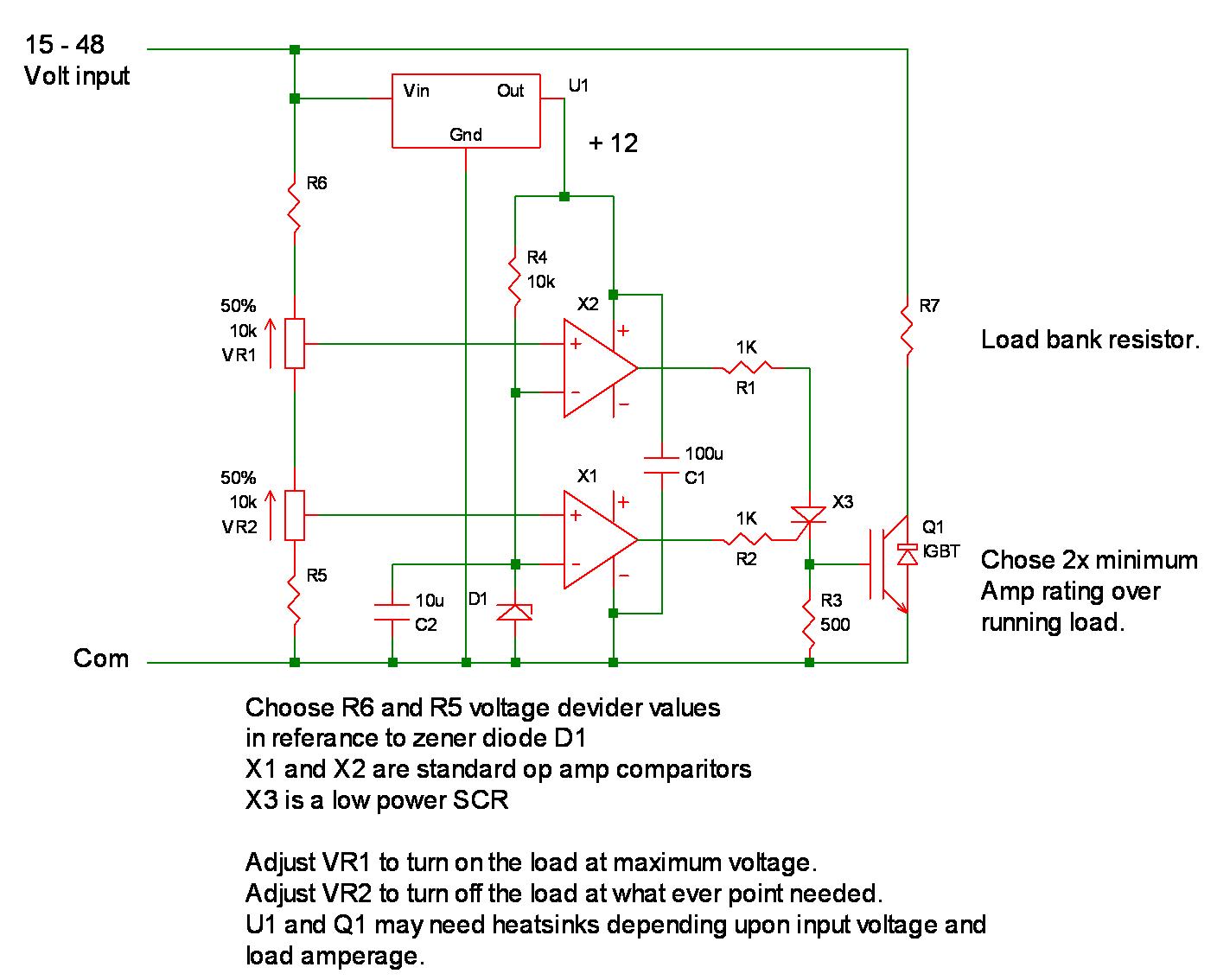

Would this circuit possibly work for what you need.
It is a high/low window switch that puts a load on the system at a specific high voltage set point and continues to pull the voltage down with a load until a specific lower voltage set point is reached and then it turns off the load it will then repeat this cycle as often as needed to keep the peak voltage under control.
Perhaps having it turn on at say 14.4 volts (common automotive running voltage)and then turning off at around the float voltage point 13.4 volts. This would still give you the full battery charge capacity but wont actualy let it overcharge and cook itself to death.
But you would still be getting your extra energy back as heat or as whatever you use as an actual load bank like running Lights or an electric motor.
Being a 12 volt system the voltage regulator would probibly not be needed or it could be replaces with a lower voltage unit too. The actual circuit running voltage is not that critical.

TCMtech, the goal for standby battery charging is to recharge at 14.4V, but float near 13.2V. Your circuit could do one or the other. It would take some additional smarts to switch between the two modes.
Continuously cycling a lead-acid battery from say 14.0V to 14.4V for 12 hours a day would dry it out pretty fast. Even cycling from 14.5 down to 13.2 and then repeating would mean that the average battery voltage is much higher than optimum. Even if there is a continuous load on the battery, the average voltage should be closer to 13.2.
The only reason cars get by with 14.2 to 14.8V while the engine is running is that it on average, the car runs less than two hours a day. Police cars and delivery vehicles typically have their voltage regulators set much lower...

Ah... true, but the whole point of the adjustablity is to be able to set it where you want for what works best in that application.
There is theoreticaly perfect charging conditions and then there are real life applications.
Also the first sentence was would this possibly work, not this will theoreticaly be perfect.
I dont use theoretical consepts very much, I prefer real life application.
Theoretical says too many things wont work, real life says they work just fine.
