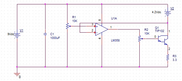

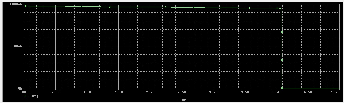

After a some time, I took AG's suggestion and found some old junker laptop batteries at a tech dump, where I was able to salvage a few good unprotected 2400 mAh cells for testing. I then modeled a simple charging circuit and am currently testing a physical prototype (see attached schematics). I ran two simulations for current into the battery versus a voltage sweep of V2: one for zero series resistance on the cell and another for a 0.5-ohm series resistance with the battery cell (see attached graphs). from what I can tell, the simulations predicted that the current would drop to zero pretty much exactly as the voltage reached 4.2V, which is what I wanted.
I am currently testing a breadboard prototype of the circuit. R1 has been set so that the voltage between V+ and the non-inverting input of the op-amp is 4.1V (I would do 4.2V, but I am playing it safe for testing in case of any input offset on the op-amp), and R2 has been set so that the collector current of Q1 is 1A when the cell at V2 is replaced with a short (or, in this case, an ammeter for setting the current). As I type this, the first set of cells is almost finished charging, and the charging current has dropped to about 200 mA, and the cell voltage directly at the contacts is about 3.95V (so I would estimate that the alligator cables I am using to connect to the battery tabs have a series resistance of about 0.75 ohms). the heatsink for Q1 got pretty warm during the initial charging at 1A, but that seems pretty reasonable here.
What do you all think? Is this a safe charging circuit as it is or would you add additional improvements? The power supply rails will be from a 9V 7809 regulator, and will be set using trimmer potentiometers, which I will then glue down. I thought that this 9V circuit with a feedback mechanism might be preferable over simply relying on the built-in current limiting in an LM317 as suggested by AG, as it allows me to manually set my charging current using the R2 trimmer.

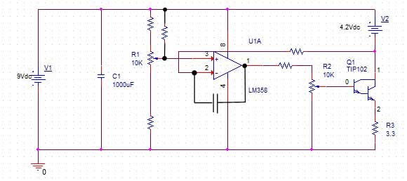

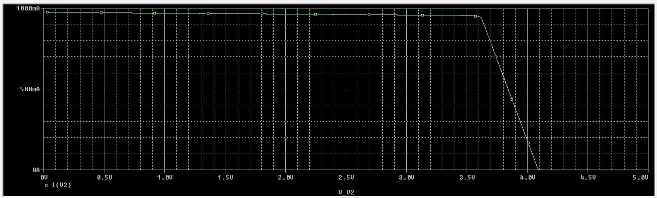

The circuit should work, but there are a few potential issues.
You are using the main regulator as the voltage reference. That will be get the largest voltage drops due to resistance in the wires etc. A separate regulator for the voltage reference would be neater, but it would have to be referenced to the positive side of the cell being charged. There is no need to regulate the main supply, as long as the op-amp and the heatsink on Q1 can take the largest unregulated voltage.
The potentiometers have no resistors at the top and bottom. R1 can be used to adjust over any voltage between 0 and 9 V, when you will only want 4 - 4.5 or so. If you put a 33 k resistor in series with both ends, you would get a range of 4 - 5 V or so. You could juggle the values a bit and put a slightly larger resistor at the bottom end if you wanted. With the 33k resistors, you will turn the resistor 7 times as much to make a voltage change, so it will be much easier to give fine adjustments.
You could similarly adjust R2 with a 6.8 k or so between it and the op-amp. That will reduce the upper range of the current limit and give somewhat easier adjustment. There is no harm having adjustment that goes to zero so there is a definite downside to putting a resistor in series with the other end of the R2. The upper limit on the current is given by R3, and is about 1.3 A, at which point the base of the darlington is at about 5.7 V. A 6.8 k resistor would keep the current a bit below that.
You should have a stabiliser capacitor between the output and the inverting input of the op-amp to stop high frequency oscillation. Also you should put a resistor the wire between the battery and the inverting input, so that the capacitor dominates at high frequencies. In this context, high frequency is anything above 1 Hz or so, but you should try to reduce the gain above 1 kHz or less.
Finally, you should have a resistor between the non-inverting input and positive. That is there so that if the wiper of R1 doesn't make contact, charging will stop, rather than doing something unpredictable, like overcharging the battery. The value of that resistor will affect the voltage range slightly, and something like 1 M should be fine, but I haven't done the calculations.

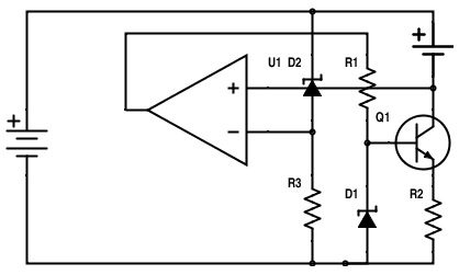

You can make pretty nice Li-ion chargers out of an LM317. This makes it much simpler, and you can add current control with a simple small transistor like a 2N2222 and sense resistor.
