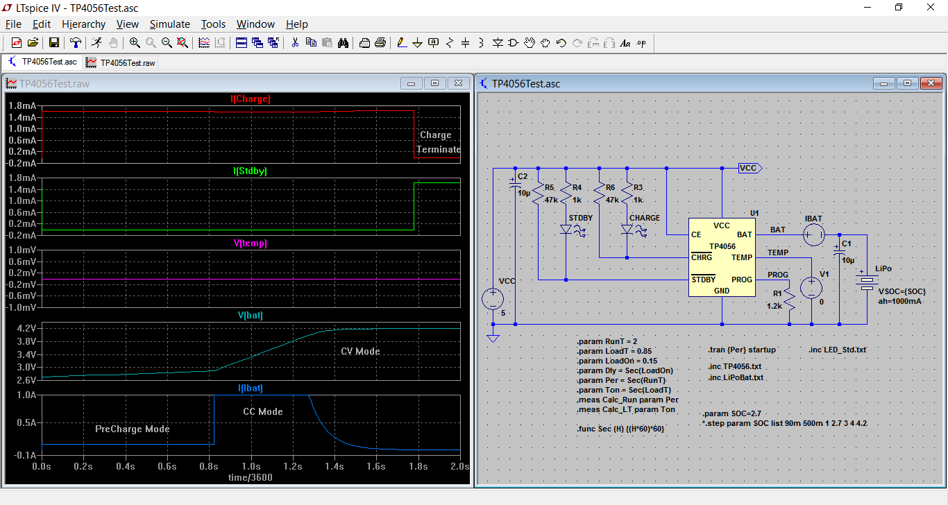

Hi
This simulation shows a typical 4.2 Li-Ion Battery Charge profile.
During precharge mode, a small amount of current is fed to the battery if battery voltage is below the charge threshold of about 2.9v.
Once the battery voltage rises above the threshold, constant current mode begins and continues until battery voltage reaches about 4.1.
Then constant voltage mode begins and is terminated when battery voltage reaches 4.2v. Different manufacturer chargers vary the duration of each mode somewhat. Some also detect the presence of a connected battery before beginning a charge cycle.
