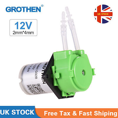

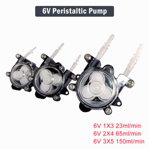

Probably a little peristaltic pump. Not fast, but simple and not much to go wrong. They just squeeze silicone or latex tube with rollers to push liquid through.
eg.
Or if you have a 3D printer, you can get a suitable small geared motor and make one yourself:
Thanks, peristaltic sounds great...but wiki says the tubing needs replacing over time due to mech stress.
