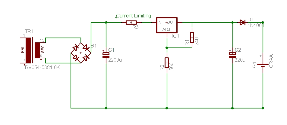

Is this too simple for the charger, I know there isn't any cutoff but I can add that with a PIC later.

Hi again,
Yes, that's the basic idea, except you dont use a diode on the output because that causes an uncontrollable voltage drop.
You also may have to adjust the 560 ohm resistor for a more exact output voltage setting.
Although i have not tried this yet, it may be possible to go higher on the 240 ohm resistor and thus also the 560 to draw less current if the power goes out. This could very well be possible because the cell to be charged will always draw more than 6ma. Something to think about, although the 240 and 560 doesnt draw THAT much current anyway.
