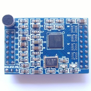

I purchased the LD3320 MP3 player and Chinese speech recognizer module made by icroute (www.icroute.com/) from eBay a few months ago. Its Chinese voice recognition mechanism can be initialized with the Pinyin transliterations of the Chinese text to be recognized, and the module will attempt to listen to the audio sent to its input channel to identify any voice that resembles the programmed list of Chinese words sent during initialization. MP3 playback is supported as well - with headphone/lineout (stereo) and speaker (mono) outputs.

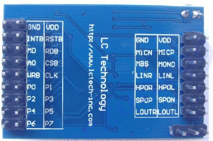

Although the PCB that I purchased seems to have some serious issues (wrong pinout labeling and ECM microphone connected in reverse polarity), I finally got it to work. I decided to make a demo video showing the module working with a PIC microcontroller and an ST7735 128x160 16-bit color LCD to display the speech recognition results. It shows the results of the module trying to recognize proper names in Chinese (bei jing [北京], shang hai [上海], hong kong [香港], chong qing [重庆], tian an men [天安门) and other words such as "a li ba ba". A single beep means that the speech is recognized while a double beep indicates unrecognized speech. Although the speech recognition quality highly depends on the input audio, volume level and other environmental conditions, overall the detection sensitivity and selectivity seems satisfactory as can be seen from the video.

Attached to this thread is the board (front and back).

Well, I got this module out of curiosity from eBay - just wanted to see how a Chinese speech recognition IC works. I cannot speak Chinese either - that's why I have to test using Chinese proper names which I can pronounce. Turned out it works fairly well. However what annoyed me was the wrong pinout printed on the PCB, causing me to waste several days debugging the issue - the labels of almost all communication pins on the left connection header are reversed, RSTB should be INTB, CLK should be WRB and vice versa! (The image of the board attached in my previous post is the image after being edited with Paint to show the correct pinout)
I am not sure why there should be this issue, knowing that the VCC and GND pins are correctly labelled.
A detailed writeup, with a description of the PCB issue, and the MPLAB X source code, can be found on my blog
