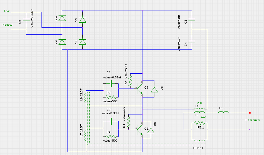

I have some of these Chinese ultrasonic cleaners. They are well put together but they are obviously a 110 volt design. The Chinese thought they would make it suitable for 230 volt operation by removing 2 diodes in the bridge so that it only runs half the time.
That is fine in theory but in truth it doesn't work. These things blow up.
I can make them much better by changing the transistors from 400 volt to 1000 volt (BU508) but it does not fix the problem that the things take too much power and run way too hot. If they are run for 30 minutes then probably 80% will blow the transistors and diodes and trip the circuit breaker.
What I need to do is reduce the on time of the transistors I think. I have tried just about everything and am hoping to maybe get some inspiration from someone that is familiar with these "magic" oscillators.
I have tried:
Turns ratio on feedback transformer both up to 2.5:18.5 and down to 2.5:5
Add base emitter resistor min 220 max 1k
Changed R1 and R2 to 100k to lower the base
Reduce and increase R3 and R4
Reduce and increase C1 and C2
Reduce and increase R5.1
Reduce and increase L5
Reduce C3 and C4
Nothing changes the way it runs. Instead of drawing 0.4 amps it draws about 1 amp. This is with 2 x 60 watt transducers in parallel.
The same circuit is used for one or two transducers, the only difference is that L5 is around 5 mH for one transducer and about 3 mH when it is driving two transducers. The 3 mH ferrite cored inductor is a lot bigger than the 5 mH one.
I am trying to avoid having to add either a whacking great resistor in the power leg or a 240/110 transformer, both those solutions are horrible.
I am quite sure that I can cure this by using a PIC micro to drive the bases of the transistors but an analogue solution would be neater and easier to implement.
Suggestions gratefully accepted.

Is core saturating? bad
Is transistor saturating < 0.5V? good
Analyze impedance of each part and check ratios of Ic/Ib
The transistors are both saturating. The 110/220 transformer is not saturating. The feedback transformer is saturating.
All as it should be I expect. The problem is the on time is too long for the supply voltage.
That might work, but the oscillator is a self-tuning type with a frequency determined partly by the transducer itself, so the micro would have to adapt for resonant frequency drift as a result of loading effects on the transducer. Could be tricky.
The feedback transformer is saturating. All as it should be I expect.
Why is feedback transformer saturation 'as it should be'? To get squared-off drive pulses for the transistor bases? I'm not well up on magnetics, but understand transformer saturation is normally something to be avoided.
I suspect the cause of the transistors frying is shoot-through. If the oscillations stop for any reason, both transistors are biased on via their collector-to-base resistors and conduct simultaneously.
If the oscillations stop then both transistors are biased off. 47k pull up versus 500 ohm pull down is definitely an off situation, L7 and L9 are only 13 turns on a one inch ferrite. This is only true for 110 volt supply, this is running from 230 so there is a possible problem.
On 110 we have 55 volts (static) on the top transistors emitter.
So
55*500/47500 = 0.58 volts
On 230 volt supply
115*500/47500 = 1.2 volts
Spot the difference. :)
Ferrite core saturation is useful for a lot of things, not least limiting the signal throughput which is (I suspect) the case here.

Can you confirm my understanding of the circuit. L7,L8, and L9 are the windings on the feedback transformer. L1 and L2 are windings on the power transformer which match the half bridge output to the transducer. and L5 is just a choke. If these assumptions are correct then I suspect that the output transformer is saturating putting excessive load on the transistors. As the voltage output will be double what it was designed for I think you need to double the number of turns on the primary (L2) of the output transformer.
Les.
The circuit is drawn by me from the PCB so is not guaranteed :)
Your understanding is the same as mine but I suspect that the L1/L2 ferrite transformer is changed by the Chinese when they issue it as a 230 volt device as it is marked 220/110 and has a 2:1 inductance ratio. I do not know this for sure but I guess that ones shipped to the US have a 110/110 transformer there, I have never seen one so I don't know for sure.

I just tried sticking a 470 in parallel with the 500 to lower the bias on the base and it seems a good result so far.

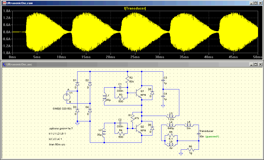

As you say, ok for 110V but you get shoot-through with 220V operation (at least, you do in a Spice sim).

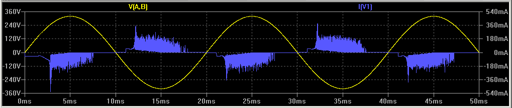

Its actually worse than that (if a transistor can die within half a mains cycle), since mains peak is ~320, not 230.

Here's a sim showing transducer current waveform (I had to guess at transducer capacitance and coil inductances, so current value won't be accurate) :-
.... and here are the mains voltage and current waveforms :-
