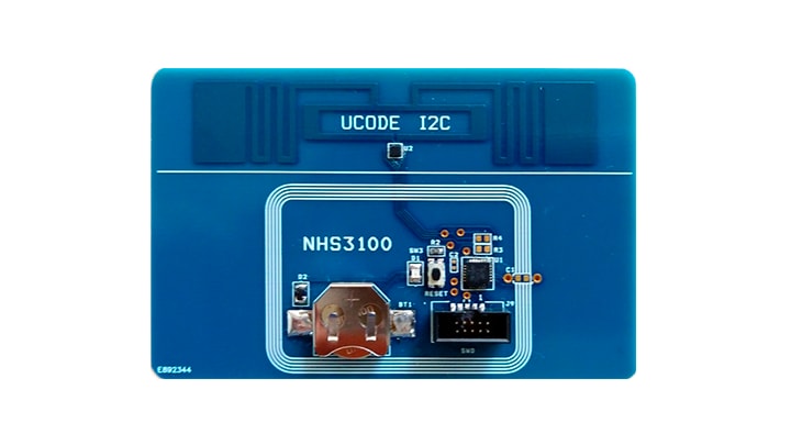

For a prototype project for a client I am looking for chips that work with RFID readers, but which have some I/O I can use. The functionality I need is that it can have data read and written from it by a wireless reader which powers it, just like an RFID tag, but it can also be read from another chip onboard when that chip is awake.
One Example I've found is the NHS3100, from the NXP series of UCODE I2C chips. But since this is meant to be a quick proof of concept and RFID and NFC are not in my area of expertise I'd like to order more than one option. It would be way easier if someone sold a chip and a reader/writer together meant to do what I'm trying to do with this. But it seems like I need to source the reader/writer and the RFID chip from two different sources.
For now I've gotten a GAO RFID reader writer:
And a UCODE I2C dev kit:
So at this point if anyone can even tell me if these probably CAN work together it would be a big help just to be sure I'm not barking up the wrong tree. If you can point me to example code for the reader/writer that's even better. Or a totally other RFID chip and/or reader. You can probably tell I'm a bit lost here. My usual business is customizing stuff like prop lights and home automation stuff so I'm a bit lost.
![www.nxp.com](https://www.nxp.com/assets/images/en/dev-board-image/NHS3100UCODEDB-DEVKIT.png)
