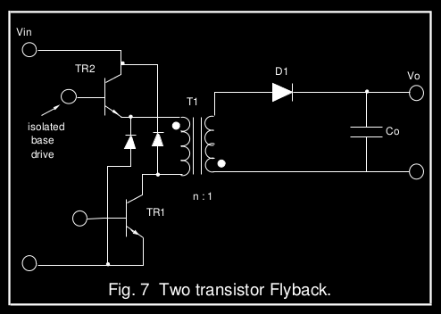

On the original topic I should have added that another give-away is that the transfomer in the LA48a is massively gapped. I think it's what you'd describe as a C-I core, with two bobbins. Both joins in the core sections are spaced to gaps that must be about 2mm. As I say, I'll get a photograph if I can.
Putting a big gap in a core is an old dodge to stop the core from saturating and also allowing a higher switching frequency. Looks like a blood and thunder design, but obviously works. Have you any idea of the switching frequency- pretty high I would think to minimize the size of the transformer and keep the switching peak current within bounds.

There's very little doubt ... that is a flyback ...unless they drew the circuit wrong.

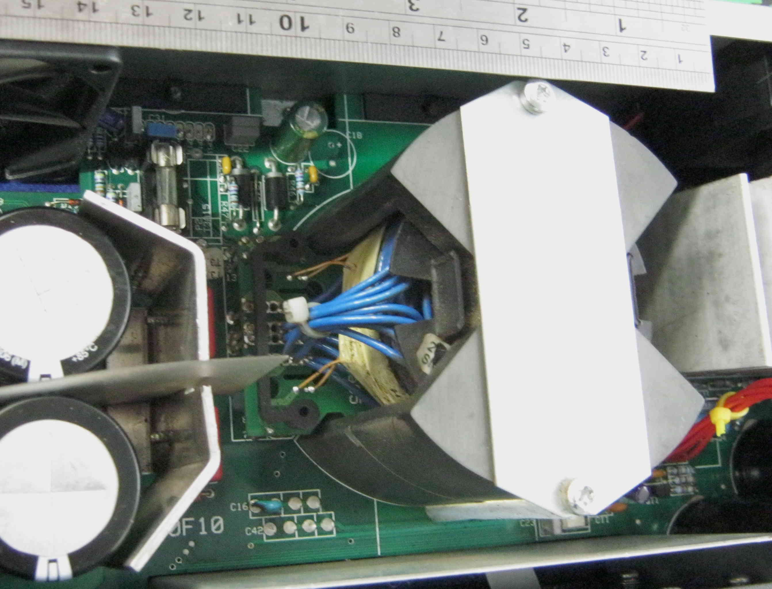

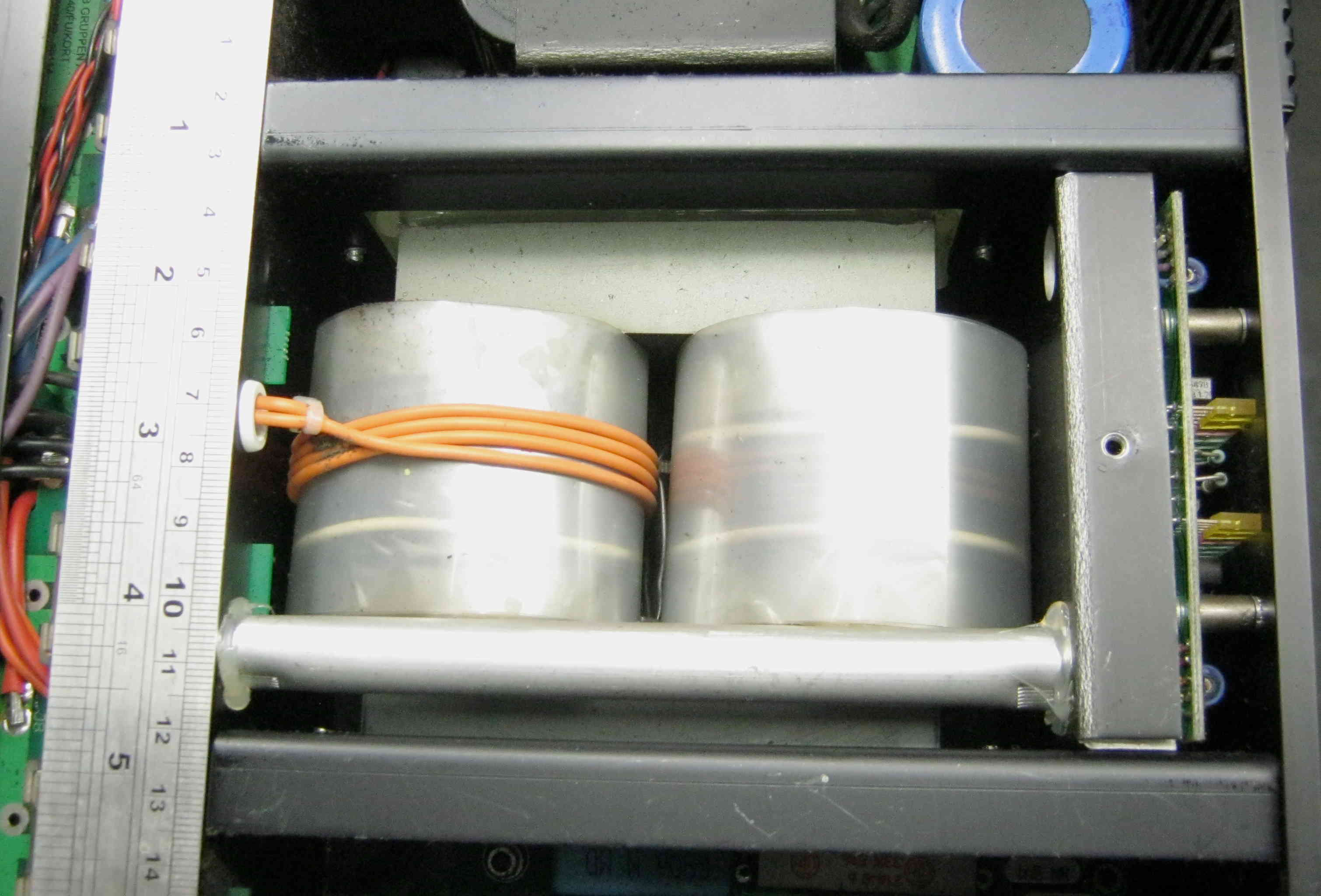

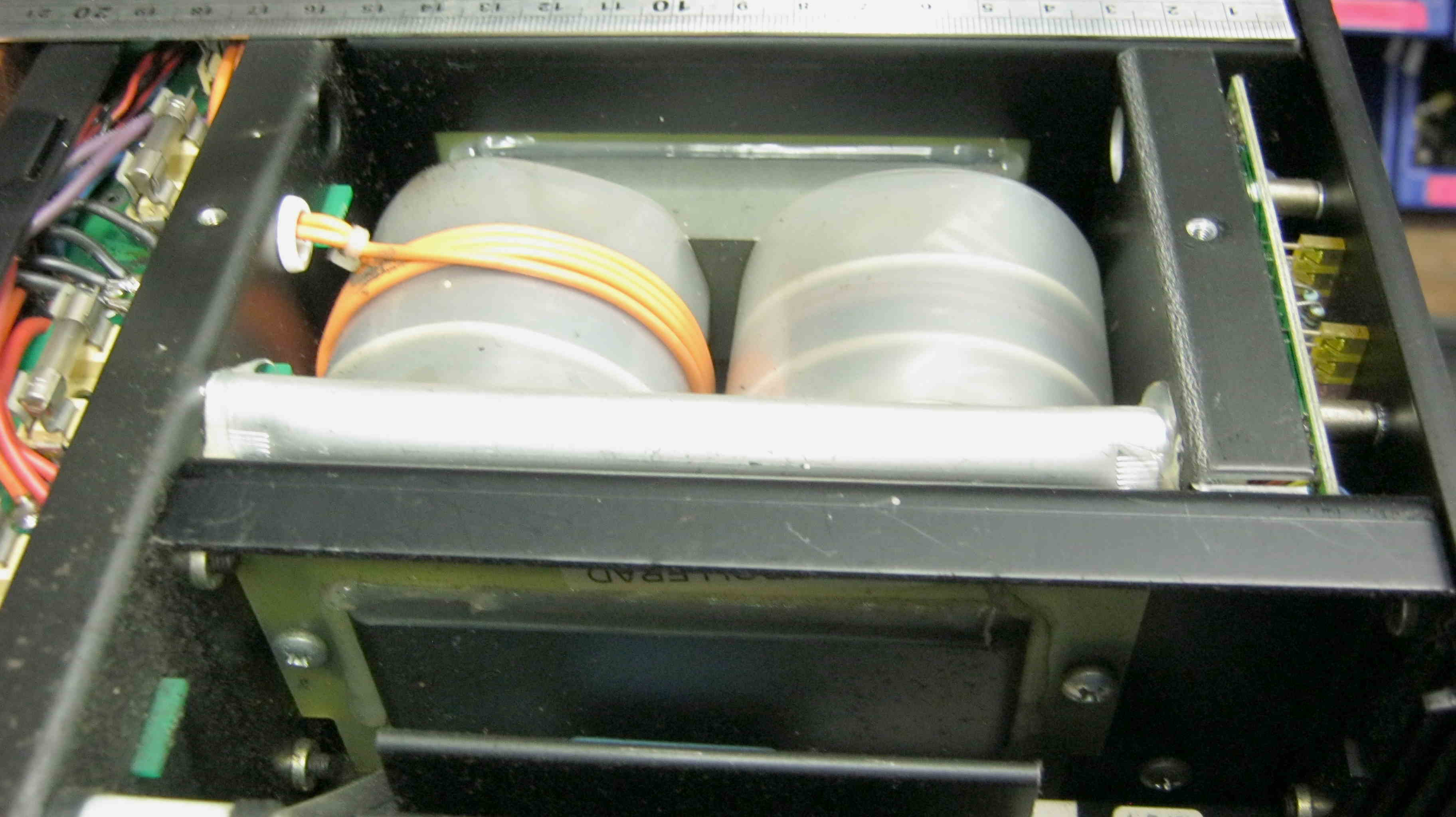

For the curious, here are some pics of the power transfomers concerned.
I fired up the PLM amplifier this afternoon (that's the one with the RM type core, the first picture, and is the newer model), and saw thin pulses with a repeat rate of only 22kHz. I can only imagine that it increases the frequency under load, or preforms some kind of pulse skipping.
One other observation is that they avoid the use of high-side drivers like the IRF2010 and friends anywhere in this equipment (the power amplifier stage has a buck pre-regulator), instead prefering to use high-speed optocouplers. Perhaps wanting to avoid the high-side switch was the rationale behind this unusual design... but then why not use a floating supply and an opto?

Hmm. the transformer is smaller than I expected and the switching frequency is lower. Presumably the amp is class AB so when it is not driving speakers at a high level it will take very little current from the supply lines. Be interesting to see what happens to the PSU signals at maximum PSU current drain.

That figure of 22kHz is suspiciously low... it was just a very quick look at the end of the day (didn't have a suitable HV probe to hand so just picked up some capacative coupling from the IGBT heatsink onto the probe).
The amplifiers are AB with a swiching (buck) pre-regulator for efficiency (I'd describe it as "switching class G"). From memory they draw about 140W quiescent, and get surprisingly warm on it!
If I get a chance I'd be quite interested in seeing what it does on load - I'll let you know my findings if I do.
20kHz was the norm several years back when all designs used bipolars. After MOSFETs came into the picture several of the controller chips did not really increase the allowable switching speed for some reason. For example, many PC power supplies still use 10kHz to 20kHz, probably because most of them still use bipolars and as you know the storage time limits the saturated switching time significantly. It could be that EMI constraints got more strict so a design that switches as 100kHz might have more trouble passing the test. There's been so many problems in that area that some designs even require a slowdown in the rise and fall times just to allow it to conform to EMI specs, and so some chips are made with that in mind, with slower rise and fall times. Such a shame really, MOSFETs can do 100kHz, but radio communication is so important too.
The core size area of the transformer would be proportional to the frequency and volume is A*D where D is the last dimension, so a transformer that runs at 100Hz and has area 100 square inches and 10 inches high could end up with area 0.5 square inches and 10 inches high at 20kHz. Quite a size reduction. We also see this in the relatively new DC 'regulated' wall warts that are made with a drop in single switch IC that drives a small transformer that weighs almost nothing.
