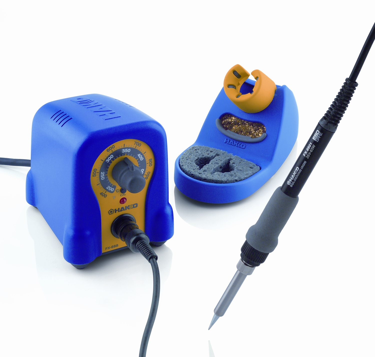

I gave my new FX-888 a try yesterday...
The station is roughly the size of an old-school pencil sharpener, and feels very sturdy. The stand is anodized aluminum and also feels robust. The hole for the pencil fits snugly and only makes contact with the collar, so no heat is lost. The brass wire tip cleaner is a nice touch. I'm not sure what the rubber scraper is good for yet. The pencil is very well made. It's light and has a comfortable grip that doesn't get hot even at 500°C. The cord is supple so you don't notice it's there, and has silicone rubber boot. The connector seats in smoothly into the station.
It has plenty of power and excellent heat stability. It gets up to operating temperature in under a minute, and holds it very steady even when melting big blogs of solder. Cool-down is slow but who cares.
I used the thermocouple temperature probe of my multimeter (2% accuracy) to test the temperature. The outside of the heater was yellowed so it must have been turned on, and I expected the dial to be calibrated from the factory but it was out by quite a bit. Following the calibration procedure, I set the dial to 350°C, but my probe barely registered 300°C. I used the included tool to turn the pot clockwise until it heated up to 350. The adjustment is incredibly sensitive so it took a few tries, and it took less than a quarter turn. While I had the equipment out, I decided to try a couple more setpoints:
200°C (min) - probe read approx 215°C
480°C (max) - probe read roughly 472 and rose very slowly as if it was struggling.
So far I'm happy with it. I'd be happy to answer any questions if anybody is else considering getting one.
Photos?

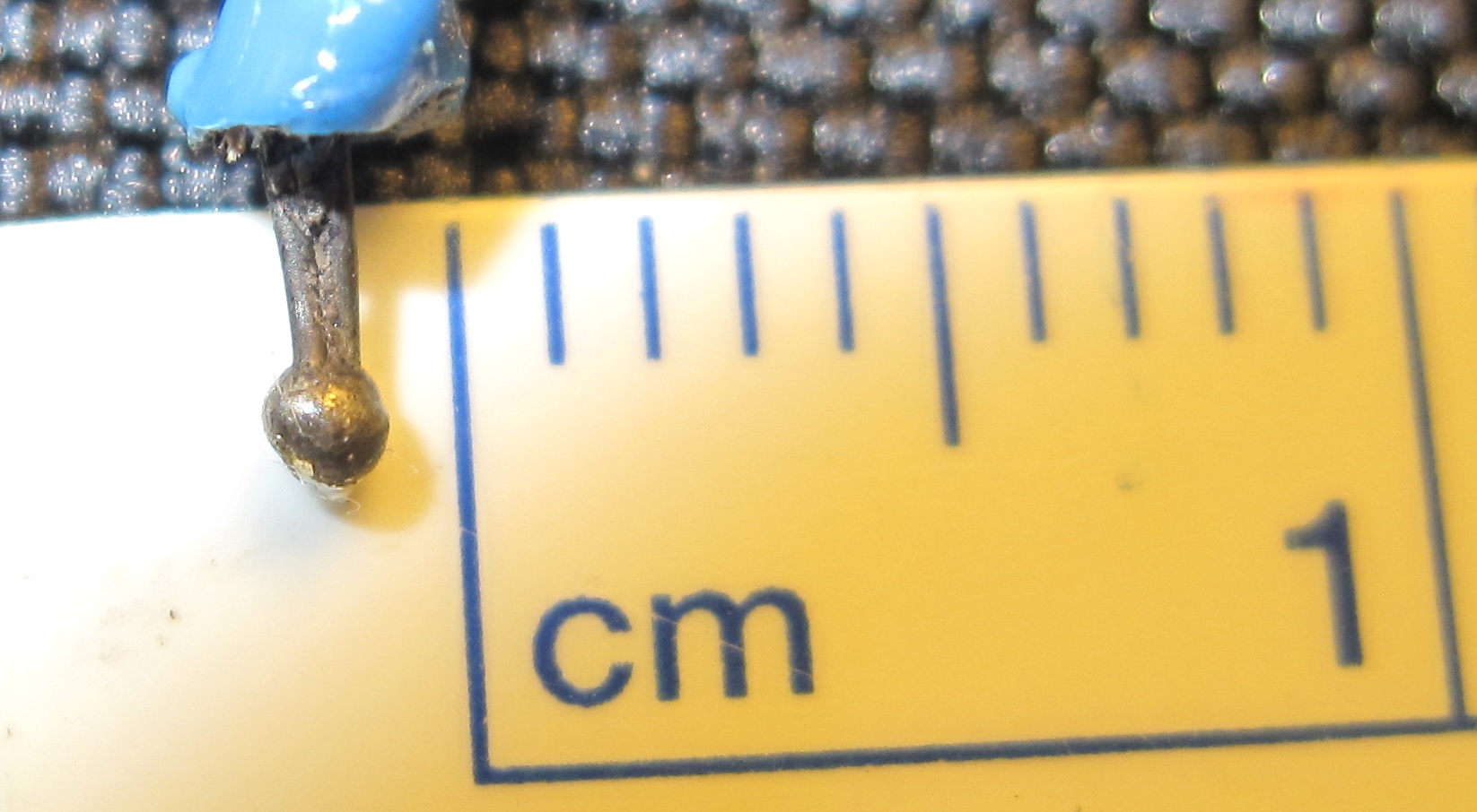

This is what I attempted to do using my DMM and temp probe. However the solder was repelled by the thermocouple, even with flux.

Reloadron on post #9 said you can use a tip with a hole cavity in it, and a thermocouple with very fine wires (so as not to draw the heat away).
Maybe it would be easier to use a non-contact infrared thermometer that would show the average temp of the whole metal mass of the tip.

So would the thermocouple seen in the photo I attached in my last post be considered large or small? I don't have any frame of reference.
