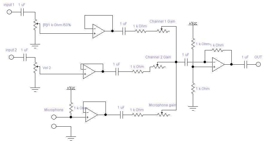

I want to make an Audio mixer 2-4 channels I am not sure yet,
if I want volume controls (yes I do) I will need logaritmic potentiometers right ?
whats the best op amp IC to use ?
I intend using something like the attached schematic please give me any comments, the component values are yet to be determined I also want to know if I can eliminate any decoupling capacitors perhaps between the first stages and the last stage ?

The diagram above is absolutely horrible! - I suggest you search on the net to find what a mixer looks like. The TL071 or TL081 series opamps are perfectly fine for a mixer, for a very low level mike preamp the NE5532 series will give a slight improvement, but for the mixer stages it's not worth it.

The horrible design:
1) The mixer has opamps biased for a dual supply at the inputs but an opamp biased for a single supply at the output.
2) It has no gain anywhere. How do you make something louder without any gain?
3) The mic opamp has no gain. If you scream at the mic then the signal might be as loud as a low line level.
4) The mic opamp should have its own input biasing and be capacitor-coupled from the mic.
5) The 1uF coupling capacitors into a 1k resistor cut the bass frequencies. 320Hz is at half power and lower frequencies have less output.
Thanks you audio guru I know the component values are scew wiff I haven't thought about values yet I just intended that as a "priciples" diagram, yes I might of forgotten some biasing i intend to use dual power supply I am thinking of a gain of 10-100 what is best ? the main inputs will be cd players or a keyboard or computer output so all of certain strength, Later I'll think of a power amp but that is apart from the mixer.
Use a gain of 11 for the line level inputs and a gain of 101 for the mic input.
thank you Audio guru I was thinking a simple capacitor mic like the ones used for computers so will 101 gain be ok for that ?
Anything in my diagram I should alter principle wise ?
As we've both explained, your diagram is completely useless and won't work. The site I posted has proper working mixers, or check this simple one I drew a while back.
https://www.electro-tech-online.com/attachments/mixer-gif.1418/
thanks for the diagram nigel I was not too sure if i could have the volume control conected straight to the output stage but if that is what you built it is fine for me as I said I don't want anything sofisticated that other link you gave me was far to complex (and not too wel explained) and I am working on matrix board. however your diagram does not look that complicated to me either the only thing you have that I would not have thought of was the condenser in paralel with one of the biasing resistors, there will obviously be a decoupling condenser between VCC and GND as the circuit will include a power supply anyway
